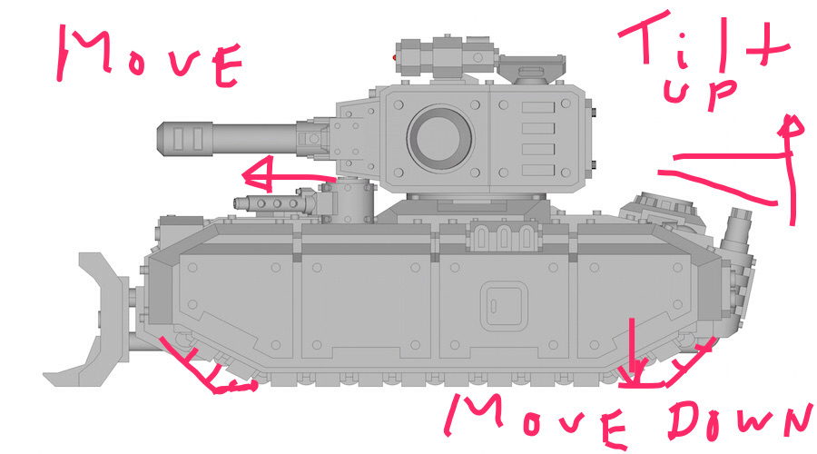

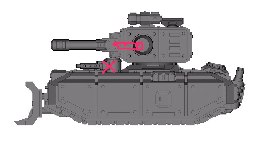

 Post subject: Re: Malika's workshop (models for Vanguard Miniatures)
PostPosted: Fri Jan 12, 2018 7:22 pm
Posts: 213
Some ideas move the mg turrets a bit forward.
Tilt the engine block and exhaust up to a level position, this will reduce the part sticking out near the tracks and it will not block the turret.
I don't think you are making this a speedy tank.
If you Put two more tracks touching the ground one on the front and one on the rear it will make the track angle less and make the tank look more solid. It will also help with the engine problem.
What about making the main turret larger and putting the mg out the sides without the smaller turrets

I mistook the position of that round part of the turret and thought it was supposed to be the axle of the turret traverse :$
SW's changes look simple and sensible to me, too (for what it's worth) though I do kind of like the chunky '40K' look versus the 'flat, ordinary' look of the actual thing (which will be preserved with those small changes, of course).
Functionality-wise, I prefer the MG turrets on the hull. MG turrets on the main turret are nifty in their own way, but then they're kind of tied to the main turret's direction (even if they swivel, they have to move every time the turret moves, and their range of fire might be compromised—but a computer could fix most of that). For the aforementioned, waffly reasons I've said before :P I do like the idea of hull turrets. For tall 40K tanks, though, side sponsons do cover a vulnerability.
I wonder what it would be like if the MG turrets were on the front corners (with some extra fortification)? Trade turret protection for field of fire?
