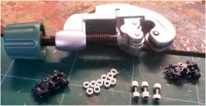

I used plastic tube for the outer rim of the wheel and filled with greenstuff to make the hub/spoke. I then cut thin strips of plastic textured card (diamond tread) and wrapped that around the wheels.

 Post subject: Re: How to make truck wheels or tyres in 6mm?
PostPosted: Sun Sep 27, 2015 1:57 pm
Posts: 1274
Location: UK/Suffolk
Getting the hang with this. All I'm adding into the cut out tube is greenstuff. Once I have the rod in place, I just poke some holes using a pin around the edge and I even got a nice hub cap.
