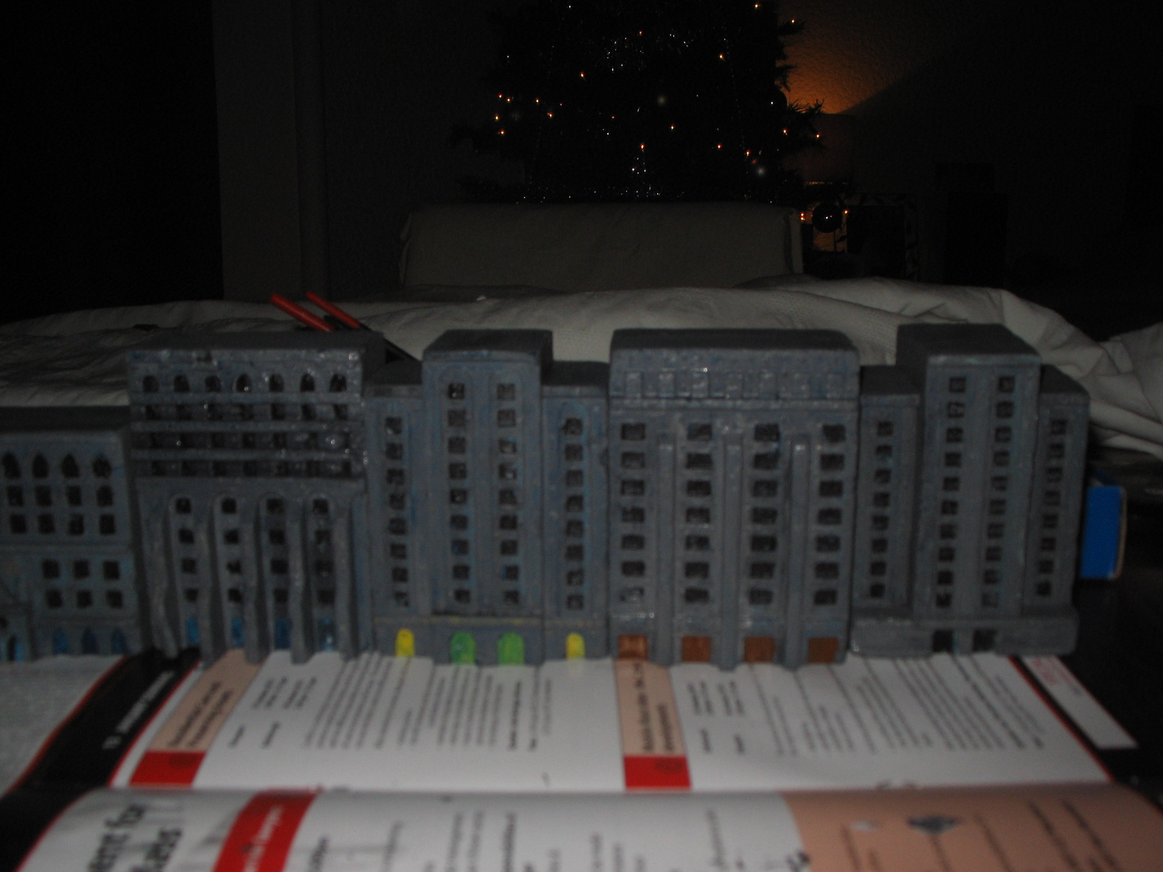

I decided not to risk it. Doing it the old fashioned way... It's a work in progress.
A 2nd coat of grey is definitely going to be required - and yes I know the still need to paint the bloody doors!

After numerous instances of tinkering with painting the buildings, I'm finally finished!... I think!

And Matt: I'll be honest, they had been painted back when I was a child. See a couple of pics above, the blue on the doors? That was what the whole buildings had looked like. If memory serves me correctly they were painted with the old Humbro paints. Not pretty.
As for my new paint job, it was all done the old fashioned way, hand painted with acryllics. I'd have loved to have spraypainted the base grey to save time but after the good people above warned me about it, I wasn't for taking chances. Painting in the black windows was extrememy tedious! Painting the horizontal lines in a lighter grey seemed to make quite a difference, it took my feelings about the paint job from "meh" to "s'alright"!
