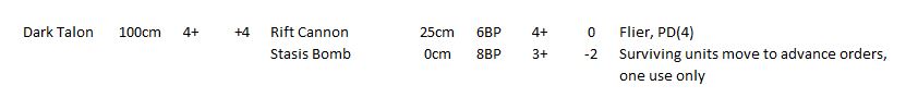

Then the oddly-armed Dark Talon
I'm not sure what the rift cannon is supposed to be, but it supposedly has 'blast' in 40k so I guess it should use a template. It's also supposed to blind people, no idea how to represent that without getting overly fiddly.
The stasis bomb is obviously a bit of an issue, it's supposed to slow down the enemy (not in terms of movement, but of initiative). I figured this into messing with Orders, but this might be a bit OP if you get your timing right, so perhaps it should be some sort of CAF penalty instead? In 40K it looks like a serious penalty, so maybe -3 CAF? Just noticed it's quite low Strength in 40K so should probably be 0 TSM.

Nephilim looks fine I'd have a read of the Ork rules and nick either the rules for the Traktor Kannon or the Pulsa Rokkit for the Dark Talon.
