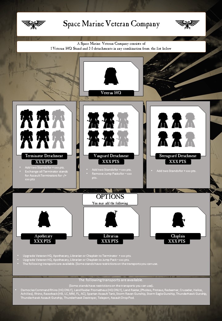

Version 0.1 DRAFT of a Veteran company layout. I understand they are still WIP but I wanted to have a go at it as it seemed quite overwhelming when I first looked at it. I think it works, it's a little prettier but isn't as efficient in space as yours for the final doc as each company takes a page. Hope this gives you something to work with and any changes you want let me know or if you just want to stay with the tabled versions that's fine. I added Jump pack for the HQ and Terminator for the Apothecary, didn't know if this was intentional or accidental either way let me know

That is a pretty good looking first go squiggle, nice one. I am sure we can play with the layout and sizes and get the formation to fit in half the page.
Regarding the mixing, that is definitely a possibility, I guess I just like the idea of mixed formations. If I did go down that route, I would still want the option of each detachment within a company to be different.

Thanks, half a page? I'll have a go. I agree, different detachment types within a company.
