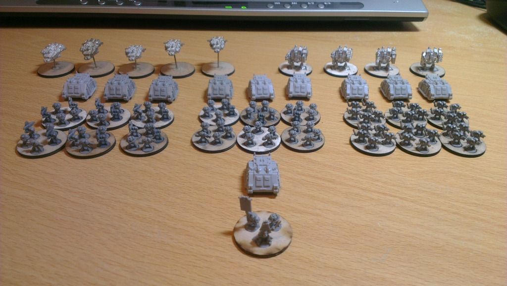

Over the last couple of years I have been getting back into Epic big time (NetEpic to be precise), but I have hardly ever painted anything, even from when I started playing way back in the 90s. In fact I have never really painted any models for any wargame apart from a single Escher gang in Necromunda, as I typically disliked doing it. I would much prefer to spend my time building scenery (which may become another log as I need to sort out my Epic terrain at some point).
But no more!!!
Part of my new years resolution is to finally after 22 years of playing wargames to actually paint a full army (even if it is 6mm).
I have bought new paints and brushes. I have invested in a painting station to keep things tidy. I have cleared part of the study to keep my painting away from the missus!
It begins!!!
Hopefully I will be able to maintain a bit of a log to show everyone how things are going. It might even transition over into ToEG if I feel like it.
To get things under way I thought I would start with a Battle Company, some Dreadnaughts and Land Speeders, to give me a chance to try a few different things.

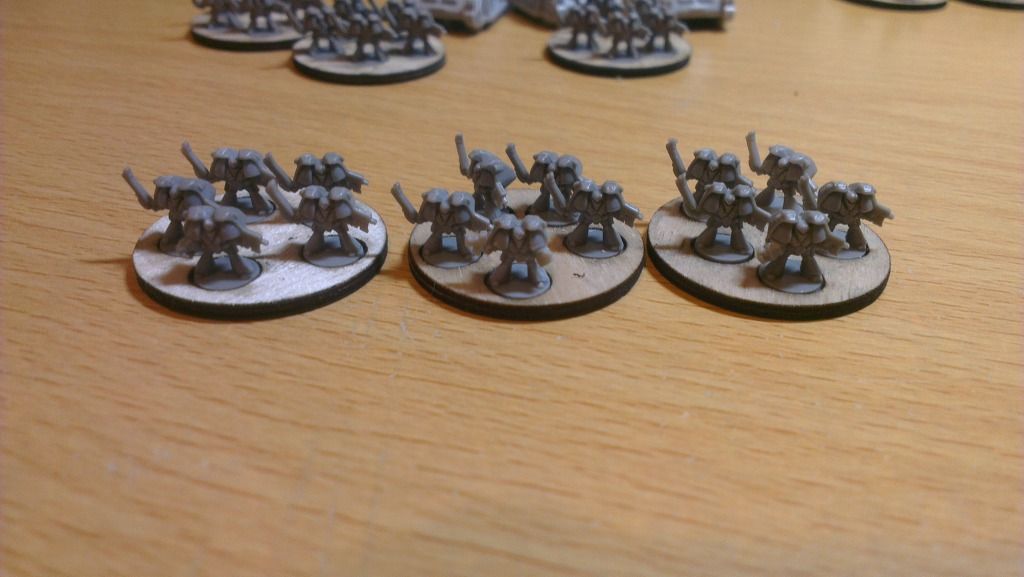

When putting my army together, I wasn't happy with the square/rectangle bases so decided to rebase them on circles. The bases come from Fenris Games who I asked to haphazardly cut the circles into them so the units looked a bit more fluid and less structured.
I also wanted each squad to be structured as you would expect in 40k with the correct numbers of Sergeants (the old Captain models are playing the parts of the Sergeants) and Heavies, so Sergeant + Heavy for Tacticals, Sergeant + 4 Heavies for Devastators, Sergeant for Assault.
Rather than using the Captain models for the Assault squads as they would look a little odd without jump-packs, I also tried my hand at a little 6mm converting and made my own Assault squad sergeants.
Not sure if the picture is that clear, but for two of them I chopped off their right arms and replaced them with the power fist from the Captain models and for the other I chopped off his sword and gave him a captains gun and then cut off his left arm and replace it with a terminators power fist.
Next up is basing and then undercoat. Hopefully I can then start getting some colours on them over the weekend.
Matt

Cheers Apoc, just wanted the Sergeants to look a little different without having to rely on paint.
@ Heavens
Everything you said was basically what I through.
I wanted the bases to be flat with inset holes like the existing epic bases rather than having a mound of greenstuff or putty.
The bases are in two parts, both made of 0.8mm plywood which gives a full depth of about 1.5mm (around the same depth as the normal bases). The top half has the holes in which is just glued to another plain one. I choose 0.8mm as that is about the depth of the plastic bases on infantry models, so they should look flush in a hole in a bit of 0.8mm ply.
Originally I got some of the rounds from Litko with no holes and then tried to drill/punch my own, but it was taking to long. Then started looking for someone in the UK that would do something similar I stumbled across Fenris and noticed these in their store.
http://www.fenrisgames.com/shop.html#!/~/product/category=2202354&id=14952053
I dropped them an email and asked if they could do something in a 25mm round rather than the rectangle, to which they said yes. Initial cost would be around £10 for 50.
In the end I ordered 400 bases (so 400 of the ones with holes in and 400 of the plain rounds for the bottoms) and it cost me £40. I was told that they give a discount the more you order, so it made sense to get a large amount as my friend also wanted some and I have plans for other armies down the line.
The bases for the Speeders are just 2 plains stuck on each other (you could just get some 1.5mm ones for those models that don't need any holes.
The dreads use two plain ones as well, but I cut my own hole in to fit the metal bases of the dreads.
The HQ unit again was just two plain ones but I wanted only 3 models for the HQ units so just drilled them myself, I can handle doing a dozen of them compared to having to make 100s of the 5 hole ones for the normal infantry stands.
If I get some time I will post some pics of the bases later for you to look at.
Hope that helps.
Matt
