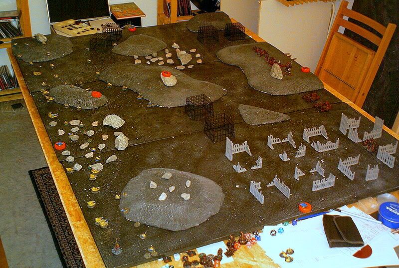

Setup
Yeah, bad picture, but on this machine editing is well-nigh impossible.
Tau in front, left to right:
T-Ps
T-Ps (garrison spread out before the lines)
Moray1
T-Ps
T-Ps
Scorpfishes
Moray2
FWs (garrsioned behind hill)
FWs in rubble near Blitz
Stingrays
Fws
Moray3
yup, forgot to place 2 Morays in a formation...  :vo
BL left to right:
Bike1
Bike2
Banelord
Arm1
Arm2
Bike3
Visit www.epic-battles.de the ultimate german epic site&forum!

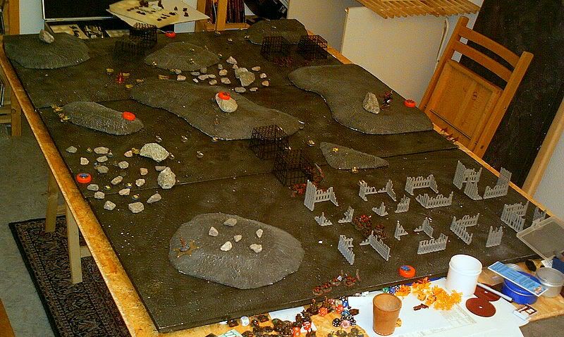

There are a lot of BL in the foreground, ready to strike at the Tau Blitz. On the Tau left flank, numerous T-Ps are in position to take out Bike 1 and mark the Banelord after finishing it off.
