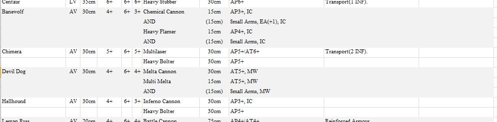

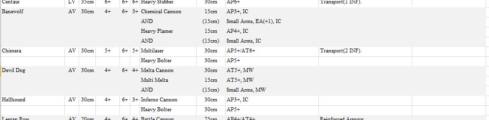

Also, while I'm fishing for feedback:
File comment: With chemical and melta death
File comment: Hellhound Variants
