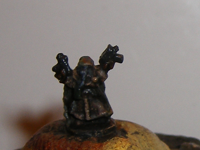

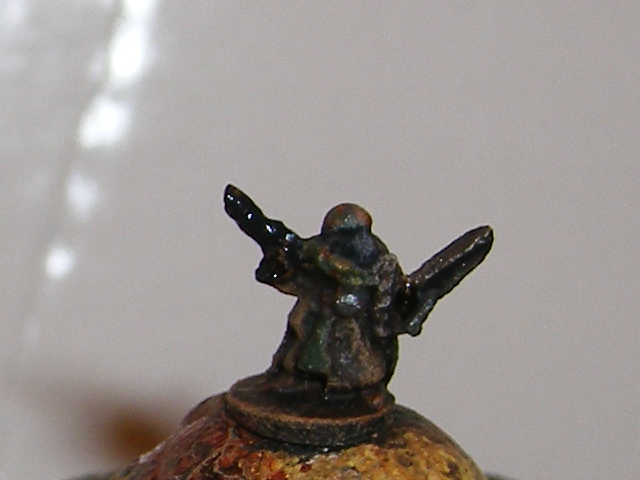

I use Poster Tac on top of old paint bottles ...
I always base coat metal with Enamel
To remove old paint from metal models I use nail polish remover. Soak the piece over night. Then use an old toothbrush. To scrub of the paint. Then of course clean off the polish remover with soap & water. Then dry.
I Always use Testor's Dullcote once the model is completed ... that is my last step ...
