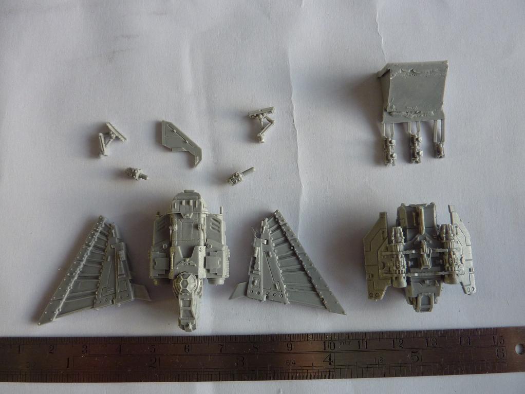

PostPosted: Tue Jan 06, 2015 8:47 pm
Arvus and Aquila from FW.
Arvus
hull length 31mm
wing span 30mm
cabin width 11mm
wing horizontal length 23mm
wing vertical width 7.5mm
Engine length 12mm
Aquila
hull length 40mm
hull width not including engines 10mm
hull vertical height 9mm
engine length 26mm
tail height 12.5mm
wing leading edge 30mm
wing trailing edge 37mm
wing horizontal width 27mm
overall wingspan approx. 90mm

Thanks for the measurements and the pics! I could have sworn they were never made for Aeronautica Imperialis, I guess I wasn’t paying enough attention to the imperial stuff at the time. I stand corrected sir. Any chance for the same treatment for Lightning or Marauder?
 Post subject: Re: Flyer Scale, Aeronatica Imperialis and other
PostPosted: Wed Jan 07, 2015 7:41 pm
No problem sir glad to be of help if you need additional measurements on these please ask.
