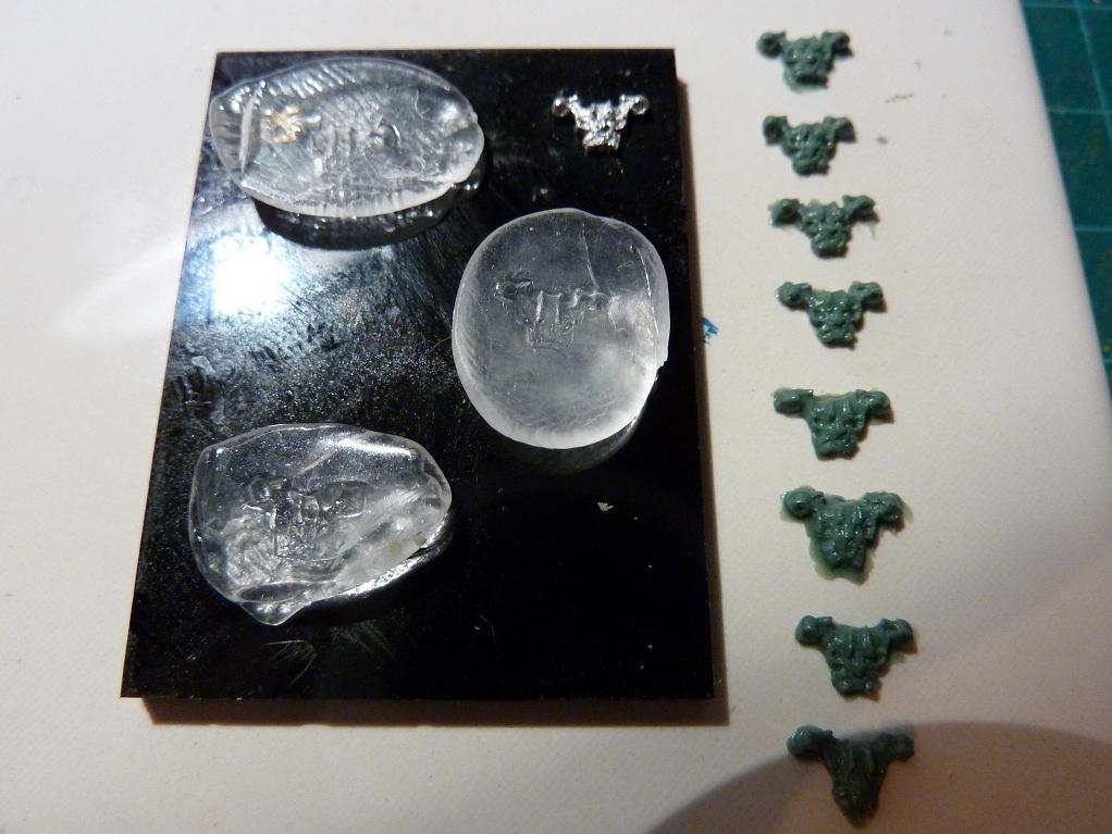

I used it to make backpacks for my chaos juggernaut riders.
