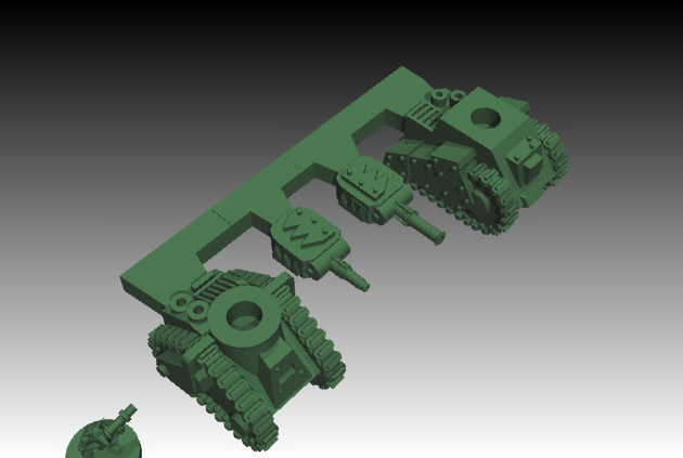

I build a rig, that will act as the feed lines for the resin when it is removed from the mould.

Do you have a pic of a rig? I'd like to see how you do it.

Rigs generally look like sprues, really.
Here's a rig I just built for some mini tanks. I'll stick it to the side of a moulding box, then cut it out later.
 Post subject: Re: Two-piece molds
PostPosted: Tue Apr 05, 2011 11:29 pm
Oh, I see. So you just glue that to the side of the box. What would you do for a model that has no sprue? I'm going to be attempting to cast my Warbarques.
