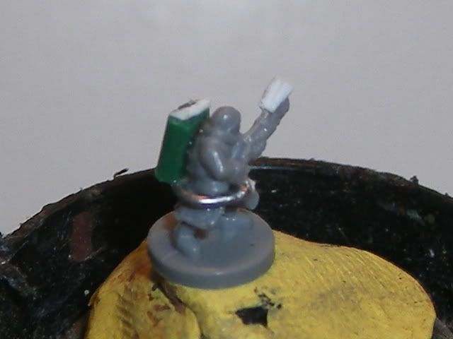

Here is a brief walkthrough on putting a Flamer together for a standard 2.0 IG supertrooper.  Things you'll need include:
-.64mm plastic rod
-1.2mm plastic rod
-.64mm plastic sheet
-thin wire
-handy tools, CA+, & poly cement
-IG trooper
*First thing I do is cut 2X bits of .5mm thick .64mm rod.  These are going to go on top of the fuel tanks.
*Next, cut a 2-3mm section of 1.2mm rod and cement it to the bit of rod that it came from.  I usually just lay both bits flat on the table, add cement to a side, line them up, & push them together.  This keeps what will be your fuel tanks relatively straight.
*Next, take a 1mm wide strip cut from the .64mm sheet, lay it flat on a table, & cement it to a section of .64mm rod.  You may want to cut ~2cm+ of length to make manipulation easier and this piece is what you will be making nozzles out of.

*One your tanks are relatively dry, add the two small bits of .64mm rod to the tops of the tanks.  This is just like doing rivits for larger models and I like to use tweezers to dip the small bits into a puddle of CA+ and then place them with a pin or similar pointy object.

*While your fuel tanks are drying, shave a flat spot on the back of your IG trooper and clip the extreme end of his lasgun off.
*Once your tanks are dry, cut them free from the main portion of rod and trim them up to right around 2mm long.
*Cement them to your trooper.
*Taking a bit of wire, put a bend in it around the end of a pair of needle nose pliers or similar round object.
*Test fit the wire from the back of the tanks to where you want it on the main body of the gun and clip it to fit once it seems right.
*Cement wire at the bottom of the tanks & the main body of the gun.  This can be amazingly fiddly and you might try to use some blu-tack to hold the wire in place while the glue sets.

*For the barrel, you want to cut a small angled section out of the sheet portion of the .64mm rod/sheet piece you glued earlier to resemble the shape of a 40K flamer barrel.
*The rod portion of the .64mm rod/sheet piece is going to be the "top" of the flamer barrel, so you want to cement a small bit of wire to the "bottom" of the sheet section.  It's easiest to curl the wire around a pin to create a rounded edge and then clip it to fit your barrel.
*If you want to add any detail to the barrel, like holes etc, now is the time.  Onc you get it cut & cemented to the IG trooper, that will be much more difficult.

*Next you want to cut the "barrel" off of the .64mm stock.  A cut straight across the piece about 1.5mm back from the front edge of the flamer should get you close to where you want to be lengthwise.
*Attach flamer barrel to the end of the chopped IG trooper lasgun.
*While your trooper dries, look at something really far away for a few minutes.  This will hopefully preserve your eyesight so that you can go on to make entire legions of flaming IG troopers. :vD
