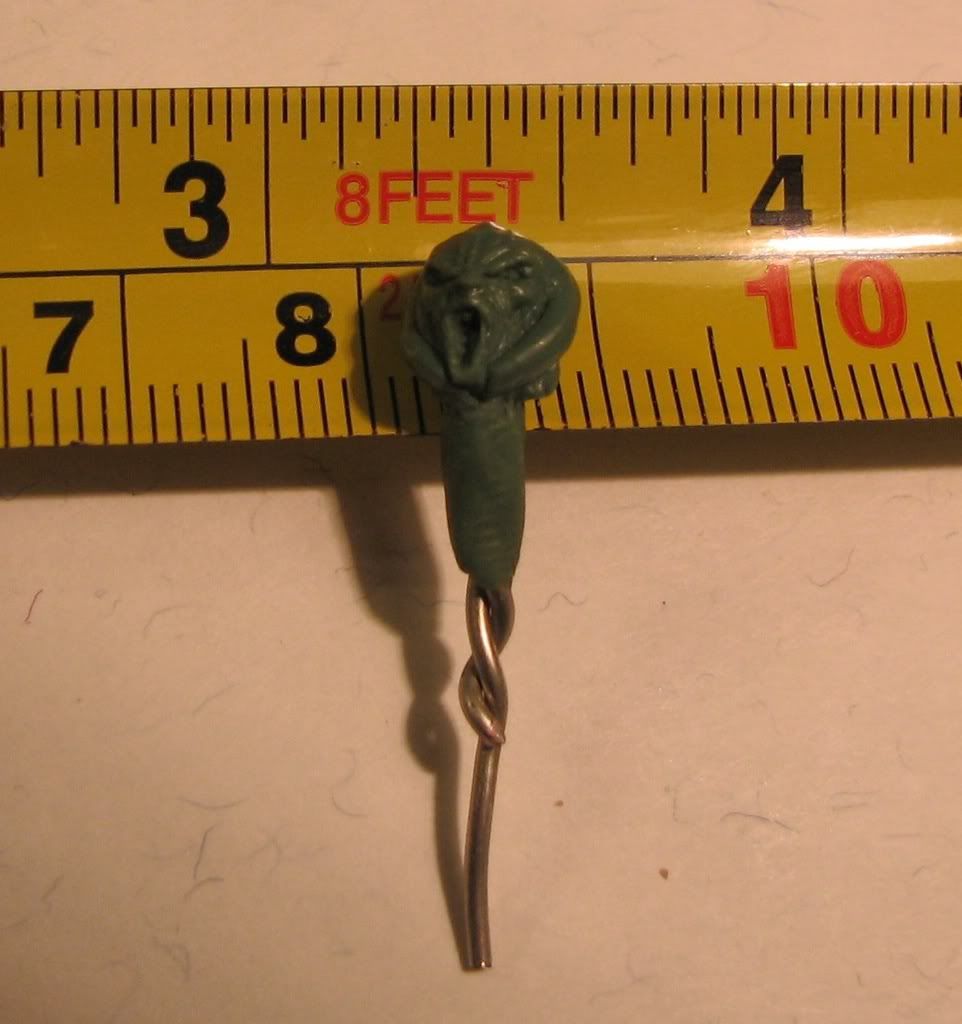

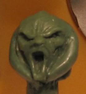

OK, here's my first attempt. I think it's probably too big, but since I found the damn thing I thought I'd post it. The cylinder the head sits atop is 3mm in diameter, although the whole head is larger. It lacks detailing (teeth in the mouth, for example) and polishing - if it's what's desired I'll finish it.
So:
Is it too big? The head itself was about 3.5mm in width, but when I added horns it got quite a bit wider.
Are the undercuts going to be a problem? Could the head be put on one of the weapon sprues instead to help with the undercut issues? I'd be happy to make some variant heads (perhaps even a head sprue?)
Is it even the sort of thing that people are looking for?
 Post subject: Petit crabe de fer en colère
PostPosted: Mon Mar 02, 2009 2:14 pm
It looks good to me. I am going to make a head assortment, so what you have there would do well.
The hole for the head peg is 2mm in diameter, so we would need to shave the peg down, or cast as is and drill out the peg. I prefer the former.
That looks really cool! I did one similar (not as good as yours) but it turned out way too big, so I dropped it.
I think otter is looking for a head sprue type deal

That's a fantastic sculpt! Looks great even in it's unfinished state :smile: Not really sure but might that not be a little bigger than it should be / what will look right in scale from what Otter said before though? If there are going to be multiple heads it's not that big a deal if they vary a bit, but hopefully some / the average will be true scale. If I'm worrying unnecessarily and that is in scale then my apologies and feel free to ignore me.
Great stuff.
I'll finish this guy off and reduce the peg to 2mm if I can (I might see if I can pick up some 2mm metal tubing for this purpose). I'll see about making two more heads then. I take it that as this is a new sprue, horns are back on the menu?
