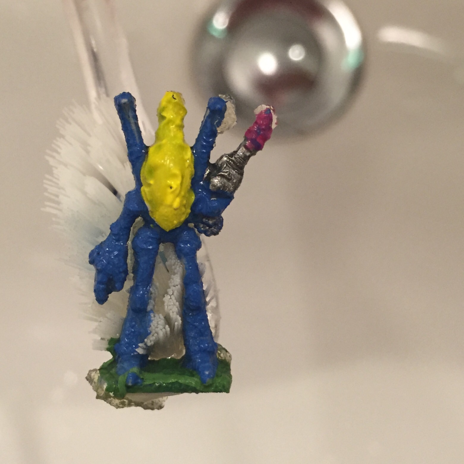

For anyone in the UK and Ireland at least that's been using Fairy Power Spray. I preformed an unintentional test on some plastic infantry. I had a very small itch to get back onto epic in 2012. Put together and sorted out an Eldar army. Some of which required stripping.
Well the last batch of test models were placed in a sealed jar with neat Fairy Power Spray. I opened it the other night after 'finding' the jar again.... :o So three years in the solution and it turns out it didn't damage the plastic at all.
Camera phone images below. :)
