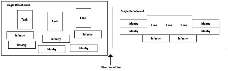

Another question,Firing macroweapons at mixed detachments:
If i get a shadowsword to shoot at a imperial guard infantry detachment with additional leman russes behind the infantry, can i choose to fire at the vehicles or the infantry or would i have to hit the closest infantry? So the Leman Russes would have 13 ablative wounds? Or can you choose to fire at infantry or tanks allocating hits to the closest of that type?

Right, so in the diagram below, a shadowsword firing at the lefthand detachment would have the hits allocated to the infantry as they are closest, but can't choose to fire at the tanks.
Whereas in the example on the right, the same shadowsword would be able to fire at the tanks or the infantry as the infantry are taking cover around the vehicles, therefor count as being in cover, so you can choose to ignore the ones in cover due to the targetting rules?
If one of the vehicles in the detachment were a war engine then the shadowsword could choose to shoot at that instead of the others but not carry extra hits over to the rest of the units?
That right?  :D

So, MW weapons aren't allowed to target vehicles?
 Post subject: Rules Questions for new player
PostPosted: Wed Feb 20, 2008 8:12 pm
Posts: 5569
Nope, they're applied to the closest units left alive after the saves frpm the non macro hits have been taken.

(zombocom @ Feb. 20 2008,14:12)
QUOTE
I understand that, when it comes to mixed formations, but it makes no sense for Shadowswords, which are specifically designed to be anti-tank. In other words, a MW is being penalized compared to an AT weapon in terms of being able to target vehicles. IMO, there's something wrong with the system when a Leman Russ can target vehicles with its Battle Cannon, but a Shadowsword can't with its Volcano Cannon.
