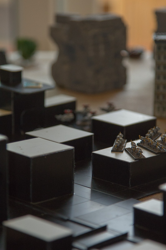

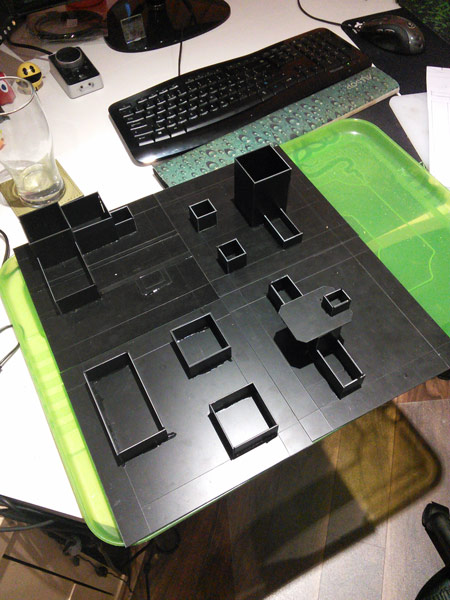

After receiving some fortifications from Psypher, we realised just how barren our gaming table was. I've been meaning to expand our collection of scenery for as long as we have been playing epic this time round (about a year or so), but never really had the space before moving into our new house. Having a dedicated hobby area, and a conservatory big enough to setup a 6*4 comfortably means we now have the chance to do things properly! (I say we, I'll be doing most of the building and painting whilst the missus supervises!)

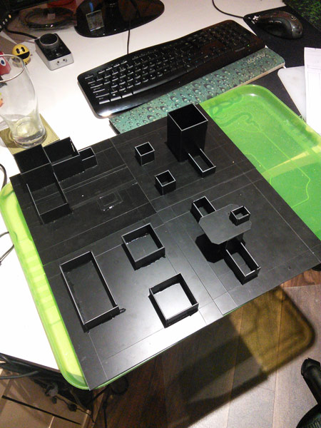

Using primarily 2mm plasticard, I've gone with 8" square sections initially, with a 1" border - which gives a default road width of 2" in the urban areas themselves. I've pencillled in some 8"X1" and 8"x2" strips to allow us to widen certain roads and allow the larger titans in to the city. All of the buildings are going to be based on a 1" square grid and range in size from 1" square towers up to the full 6" square allowed per tile. Vertically we're going for approx 1" per standard floor so building height will range between 1" and 4". I have a few ideas for larger multi-tile features, but these will have to wait till I can pick up some a3 plasticard. In amongst this there will also be some urban canal/river sections and a combination of light/heavy bridges.
I'm still toying with how to go about detailing things, but the plan will be to make up some template panels in inch square multiples for building detail and cast these up in bulk once Im happy with the structure and the style.
I've put the first four sections together so far, and am fairly happy with the results.
Another plus of the 8x8 with a 'free' inch on all of the edges is that I'll be able to put together a storage rack something a little like this....
Will hopefully make some quick progress once I pick up some more materials :)

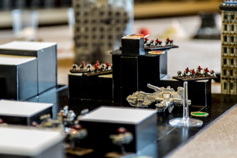

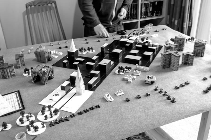

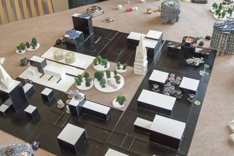

Played a couple of intro games with my bro yesterday, so was able to test out the size of the sections.
I've got eight so far, before running out of plasticard, but the size and shape seemed to work well. Talking while we were playing yesterday we scribbled some ideas down for more sections, with rough sizes and details of how they interlinked so I'm gonna get me some more materials this week :)

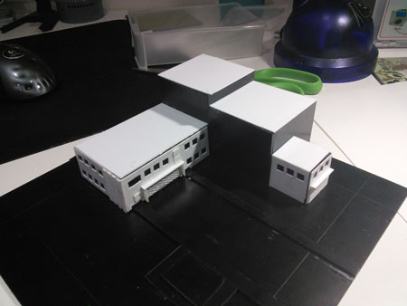

Thanks guys. I quite liked the idea of pick-rotate-place. It worked quite well at the weekend playing with my bro-in-law. We left a 4" gap between sections this time to see how my plan for roads would affect play. It ended out working really well (for him) after I strode my imperator right into the city centre laying waste to his ork clans. Only to come undone (and fall over) after being hit by a chain-shot from his great gargant! thankfully it didnt land on anything.

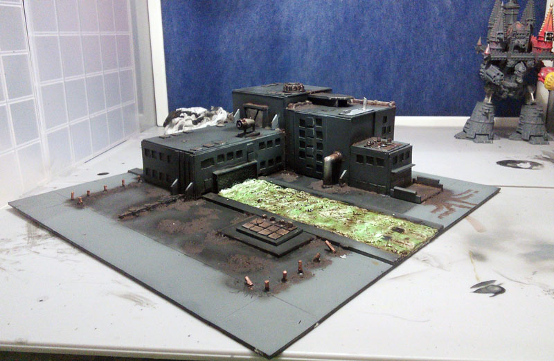

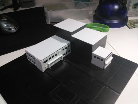

A small update on the section I'm currently detailing. The plan is to use this one as a test bed to work out a general style and methods, then make up a master copy and cast multiple panels. I'm working on a water refinement / processing plant that spans the river as it covers a few different elements that I need to work out.
File comment: Refinery Panelling

Finally getting some hobby time in (and a chance to use the airbrush in the house now I've got my booth setup and working :)
Almost finished my test section, a processing plant that spans the river/sludge canal ;)
 Post subject: Re: Modular Urban Terrain
PostPosted: Thu Mar 27, 2014 11:20 pm
Posts: 931
Nice! I'd say you passed that test!
