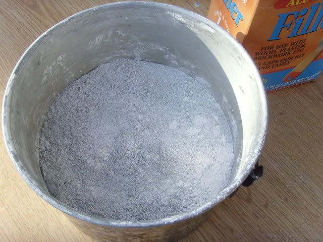

A mixture of budgie grit (for texture), wood filler, black cement dye powder (saves painting it) added to a degree for GREY, and a bit of PVA to make the mixture stickier.

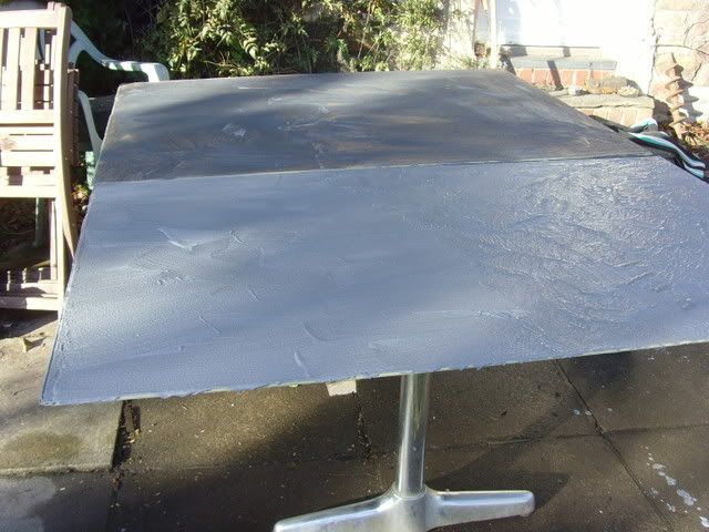

Step 4 and 5
Firstly a thin later of the mixture is painted on in thin strokes; it dries quickly, provides a darker base layer (don't ask me why!) and -again- gives extra adhesion.
The top layer is then painted on and then'flogged' on with a large paintbrush in order to give it texture.  Allow to dry.
In the picture above the first layer can be seen the the rear, the top layer before flogging at the front left and the effects of texturing on the right.

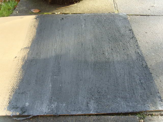

Roads
Part 1
I also found a bit of plywood sitting around; my landlord leaves random bits of frightful all over the house and he doesn't live here anymore; i'm the one that has to live with it and so i see this as...recycling!
I mixed the remnants of the above mixture to a darker shade and applied it in one direction to the plywoods 'rough' side.  Once it's dry i'll cut it into strips, crossroad and other junctions before lining and defining the sides with static grass.

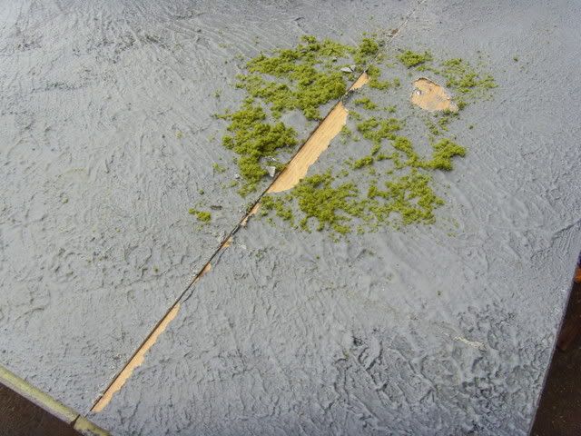

*Lack of pictures means that words are all i can use to describe the disasters going on my end*
Sorry for the delay...i've not had any problems with warpage, but -just when i thought i was finished today - i discovered that i hadn't braced it sufficiently on the outside edges, the result being that one of the 'joints' came undone and i had to rip it off, and go over it again with a batch of filler i had randomly mixed for my tyranids.
Additionally i'm finding that the filler doesn't stick at all to the floorboard; so i can see these being very short lived; if you've got some of yr own then i suggest using the side that would be attached to the floor; why i didn't to begin with i've not idea.
MORE problems ensued when i discovered that the flock/rough shrubbery that i bought doesn't really want to stick to it, i tried daming it down with a 50/50 mix of water and pva; that didn't really work and just made it soggier and started to 'float' off instead.
On TOP of all of that when i attempted to make a 'wash' to shade the matt grey that it was BEFOREHAND it all ran out and made things mottled; so i ended up having coat the whole thing in emulsion and drybrush highlights on; which worked really well (at least something went right...)...until i found that the black was GLOSS!!!!  :evil:  :evil:  :evil:  :evil:
Bad weekend. :_(

The possible problem in turning the boards over is as they will have no coating they may warp and twist a bit with a lot of liquid application, I would suggest a heavy grade sandpaper and a light sand should roughen up enough to 'take'
Other than use another glue, perhaps a more 'oil' based one for the flock, I've no idea on that one.
