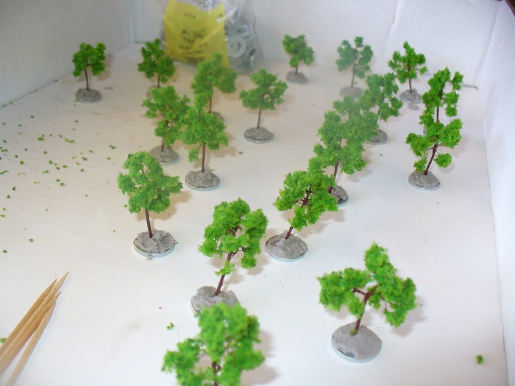

I got some neat Z-scale trees off Ebay for dirt cheap. Because I wasnt sure how I'd store my terrain if the trees were attached directly, I decided to mount the trees onto little 5/8" washers using Pre-Mixed Concrete Patch.

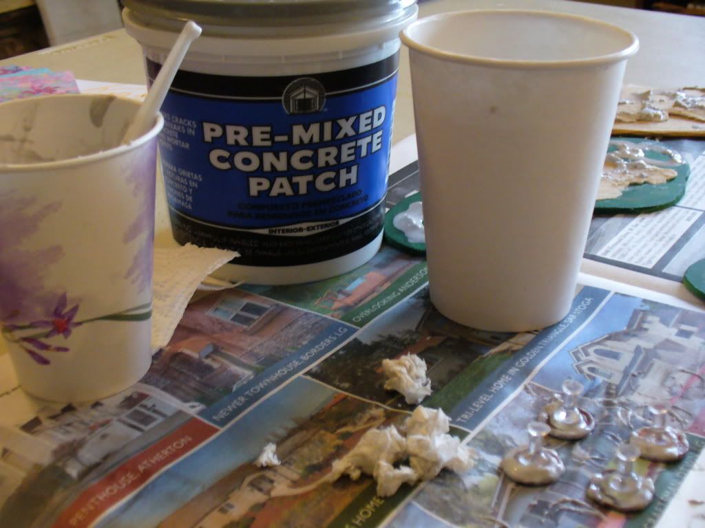

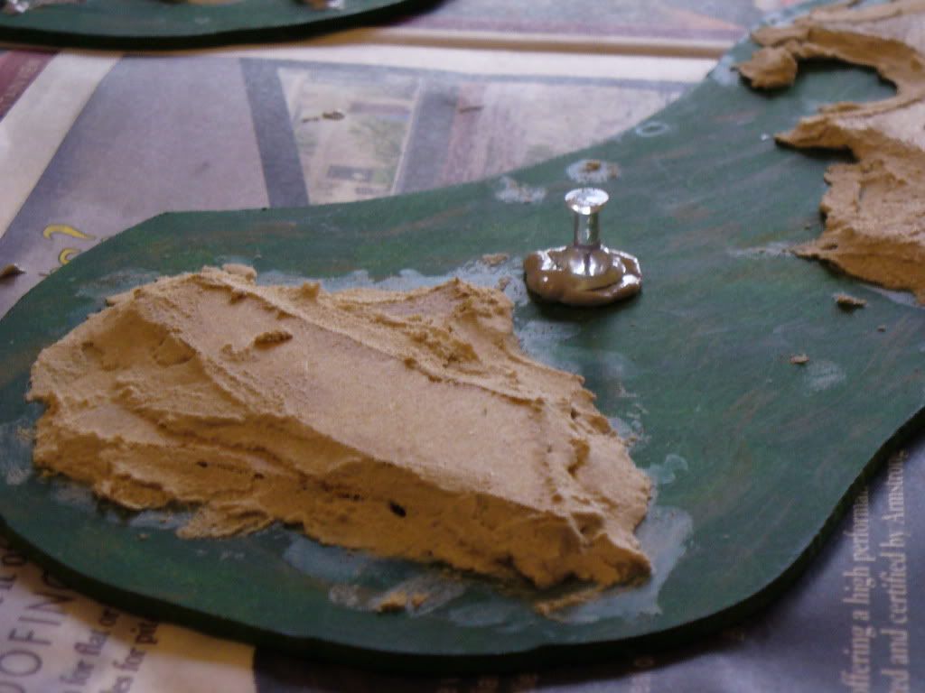

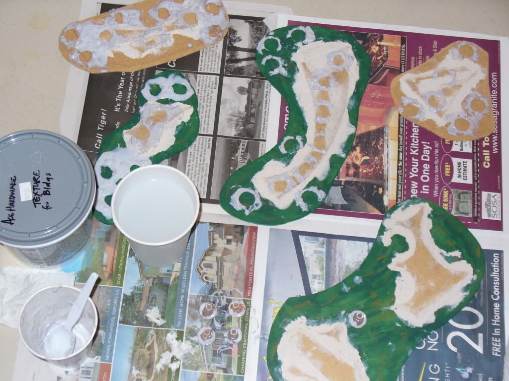

I found that US pennies were the size I needed, and hot-glued some push pins (sans the sharp pointy part) onto them. Then I placed the pennies on the templates and dropped the concrete patch around it. After lifting the penny off, little neat circles were left, inside of which I will put the self-adhesive magnets.

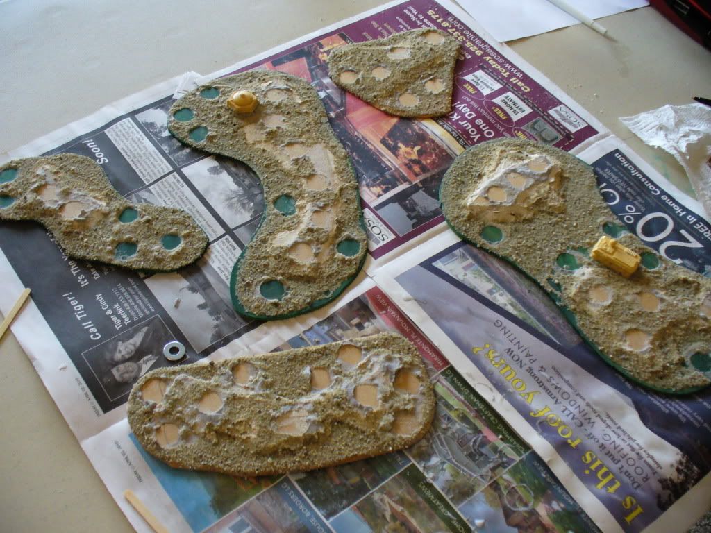

Here are the templates with some additional MDF mounted for variation, with the process of isolating the tree magnet locations:
A close-up of the process as Im doing it:
Tools used:

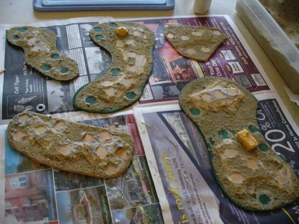

After the concrete patch dried, I watered down PVA glue a little and applied ye olde Beach Sand to the bases. Maybe the beach sand was a TAD too textured, but I thought if I used my nice fine hobby sand that I wouldnt get the drybrush variation I knew I'd need later.

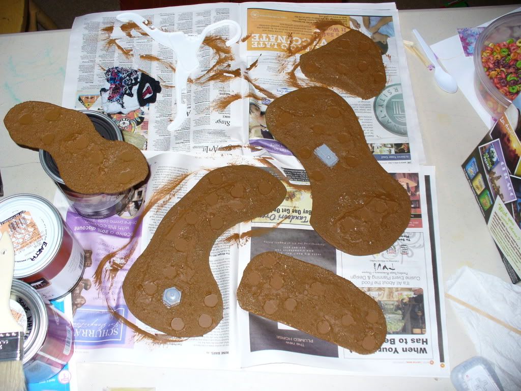

I let that dry overnight and then painted the first layer.

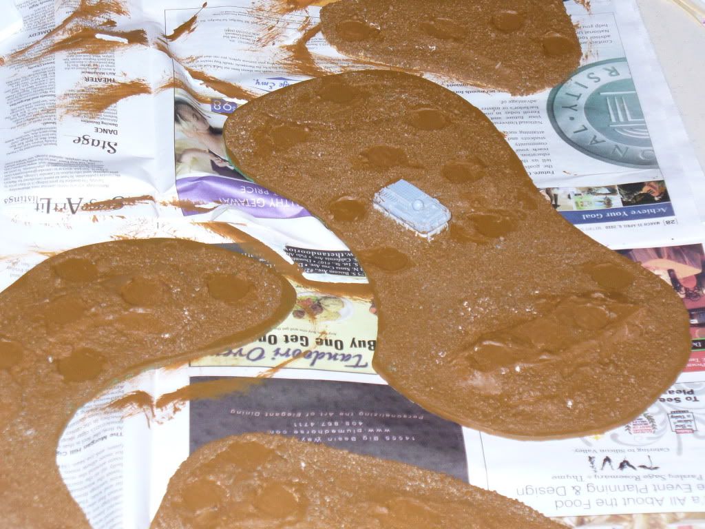

I had gone down to Home Depot over the weekend and had some paint matching done. This first color was Vallejo Beasty Brown, done in the Behr Premium Plus Ultra, which is a Flat Interior paint with primer built in.
You can kind of pick out the places the magnets are going to go.
The next two layers, also matched at HD, are Vallejo Earth and Bone White (the astute among you might realize I am also, in effect, using GW Beastial Brown, Graveyard Earth, and Bleached Bone).

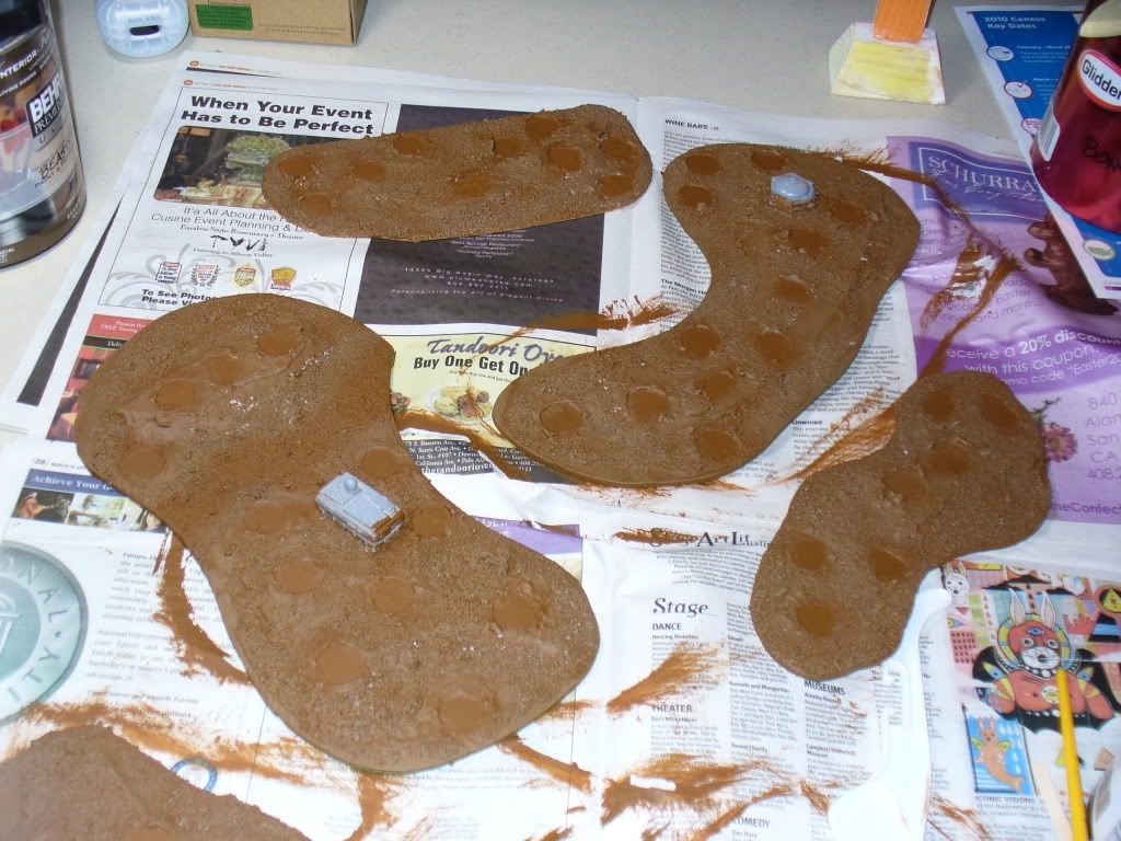

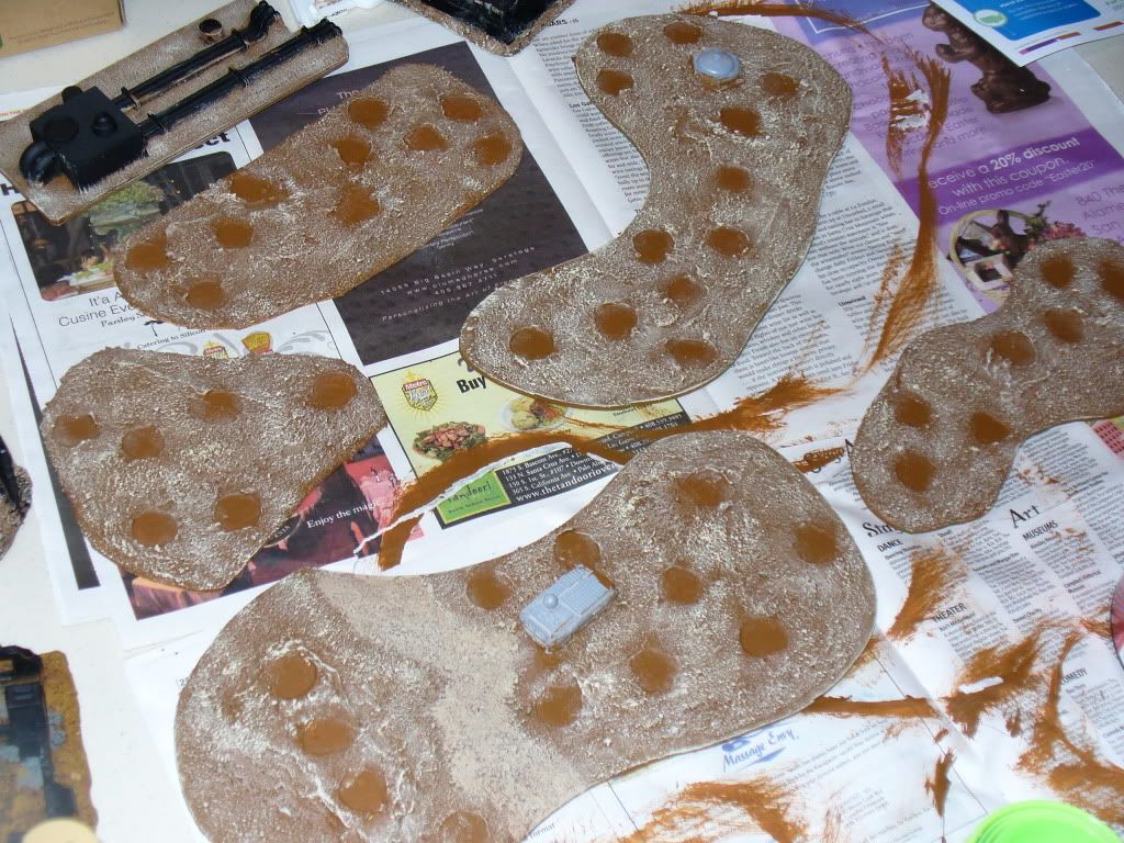

I got two more layers of the drybrushing done last night and this afternoon.
This is with the Vallejo Earth added. It toned down the dark Beasty Brown very nicely:
This is after I finished up with a drybrush of the Bone White:
For the road, I hit it with some Apple Barrel "Country Tan" and washed it with a very watery mix of water and AB's Chocolate Brown. I'll hit it with a drybrush of Country Tan again, I'd wager.
First, let me critique my own work:
I think the browns are lovely, I am glad I invested in quart-sized cans of these colors, and they will serve me well.
I also think they look horrible for tree stands!
Granted, I'll be flocking these with green flock and bits of Woodland Scenics Coarse Turf and Fall colored flock, but I think I really should have used a green base under all this.
Maybe I just havent read enough about other people's woods. What do YOU use?
Chime in, please :P No one offered anything on the road so I took a stab in the dark. Ideas?

I think that you went wrong on the bone drybrush. The effect this has had is to make it look decidedly un dirt like.
What you probably should start with is a black undercoat and drybrush on the brown you are using over that. From there stipple in a more red brown or green brown like the GE graveyard earth for variety. From there you can do a light drybrush with bone or khaki, though if it ends up how yours did you will probably want to give a wash of a reddish brown over it to knock it back and make the colors fit.
Especially with larger chunks of terrain you will want to vary the colors to give the impression of different dirt compositions and might even want to include gray to emulate some kind of gravel or rocky areas.
When I was doing my large hill section, I also kept a damp brush handy to blend in the dry brush colors and give a more natural gradient. Once you knock the highlight back into a dirt looking format it will look fine once flocked.
-Vaaish

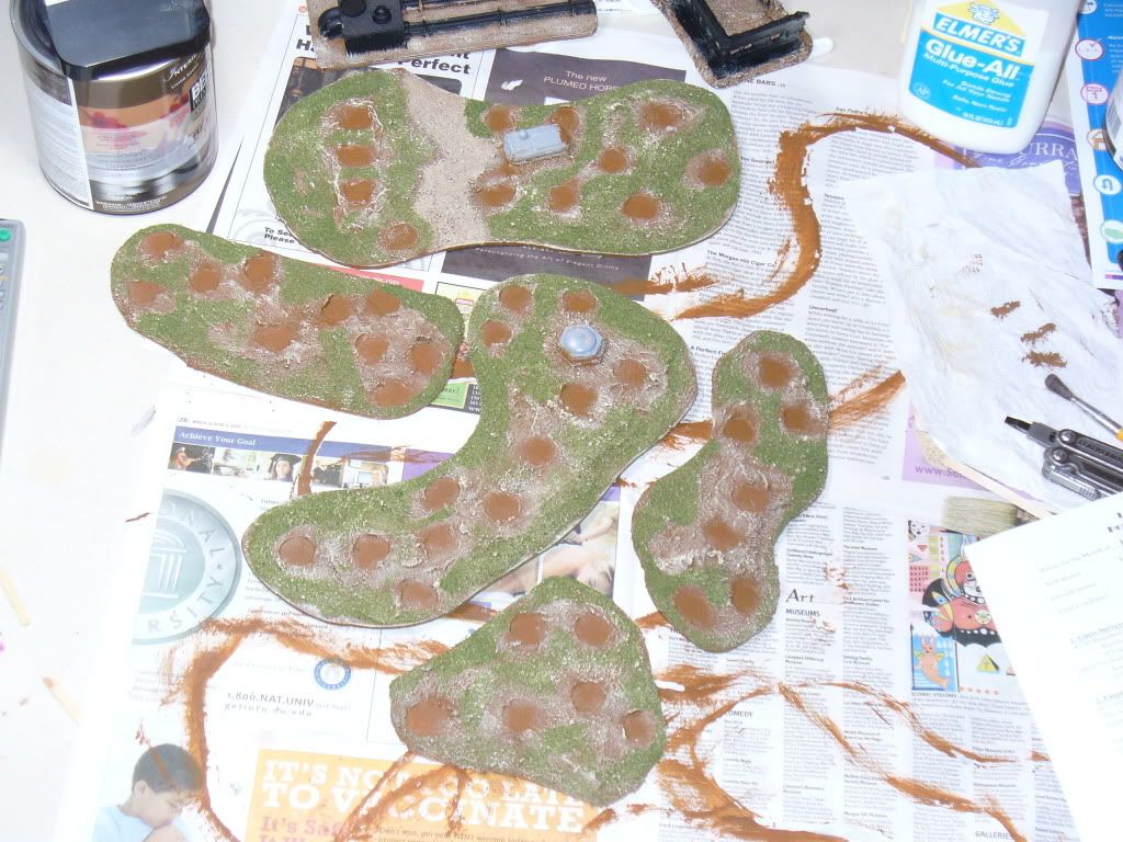

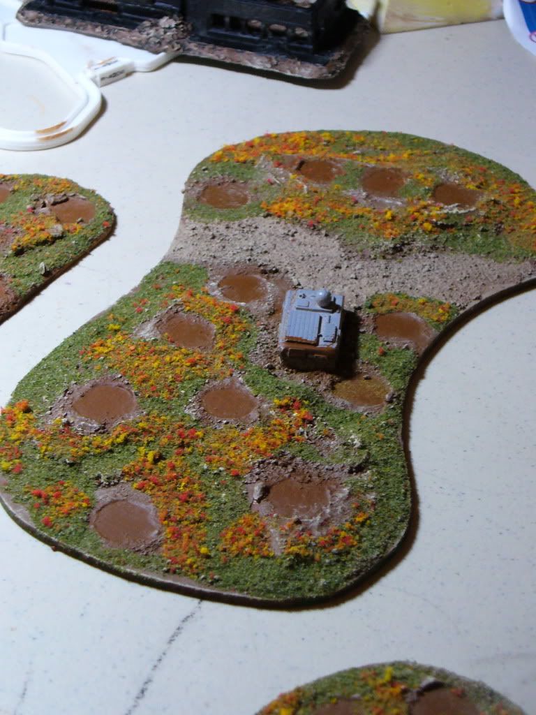

With flock added. No drybrushing done on the road yet, fall colors not added:
Much better! remembering that the dark brown circles will be covered with adhesive magnets and ultimately be hidden with the attached trees, I think the mistake of the Bone White is certainly mitigated. It actually blends nicely, and now that my panic is gone, Im happy with the scheme.

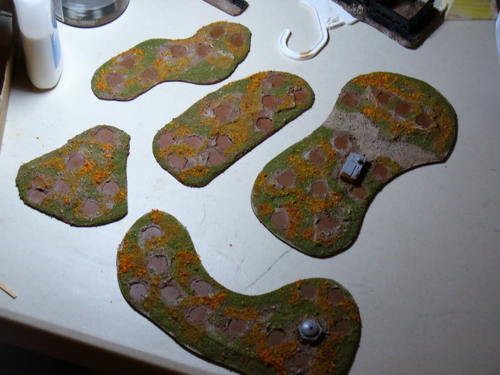

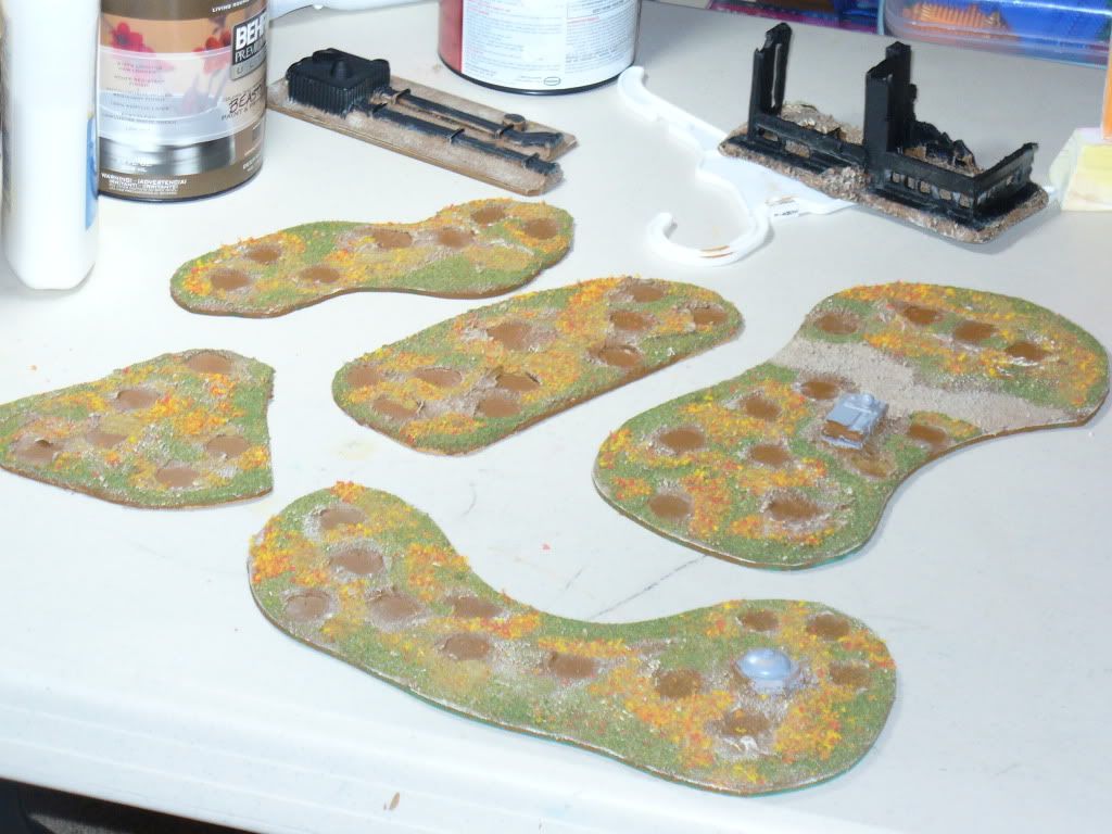

Getting closer...
Here is the Autumn flock mix I added on. Still to do: Drybrush the road, finish sealing in all the flock, painting the 2 buildings, and putting on the magnets!
Sorry about the lighting:
