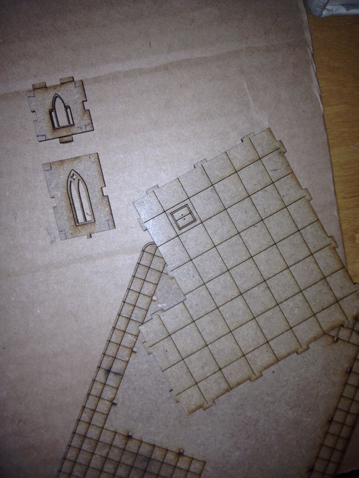

File comment: Straight/inside corner section

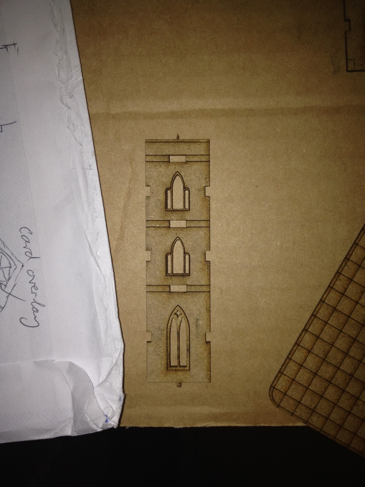

File comment: Outside corner section

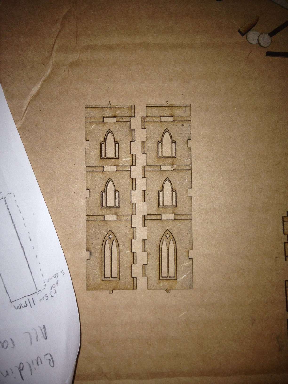

File comment: Roof and floor tile, plus some mockups of fully modular tiles.
Although the segments shown here are currently 3 floors high, they would be available in different heights. Another alternative I am working on is to try and create a fully modular option, with each floor being a separate segment, allowing complete customisation of height and overall look. Doing this will also allow for far more customisation and variety when placing battle-damaged segments and would mean roofs can be removable to aid in placing miniatures in the ruins or to allow battles to occur inside some of the larger factory style buildings. I haven't tried this out yet, but too much in the way of modularity will affect the rigidity of the building and make it too delicate. At the moment floors and roofs aren't modular, as they provide much of the durability of the structure. I am working on this, but if I cant find an alternative then floors and roof tiles would be bought separately and give an indication of how many wall segments would be necessary to complete a floor. There will also be buildings available to buy as a one click pack to make things simple if some people aren't bothered so much about the customisation aspect.

There are currently corner pieces and straight bits, the only problem with creating a specific interior corner segment is that there would need to be four versions of it depending on what tile would be adjoining on to it. I want this system to be modular but also relatively simple, which means keeping the different types of tile necessary to create a decent building down to a minimum. With the corner solution I am working on however, there wouldn't even need to be these different corner/straight segments. Concepts I have in mind at the moment include factories, (with working hangar doors in different sizes for tanks, titans etc) city district walls that divide areas, airport buildings and runways, military buildings with less of a Gothic feel to them and residential buildings. I always thought most imperial citizens would eat in large central canteen type buildings, much like some parts of Russian have, I'll make some sort of large building with a central open air courtyard that can be used for this sort of thing or as a commercial area, thanks for the comments!
@spectra Ghost - Don't worry, the gaps in the corner would normally be scored in to allow the end user to snap them out or keep them in depending on whether it would be used for a corner piece or if they didn't want to attach buttresses, but I only cut one straight piece so had to use the same one moved about in the photos! I think I have a solution for the corner problem, it also lends itself to even further modularity by having an option for corner buttresses and allows door segments and other specialty segments to be placed right next to the corners, though it'll involve a little more modelling skill on the part of the person putting the kit together. I'll try it out this weekend coming and see what happens.

You know, the more I look at the tile floors and walls, the more I think you could easily make a 6mm zone of mortalis board

Funnily enough I was thinking the same whilst doing some designs tonight. As it stands the modular city tiles I mentioned before are customisable themselves and could have wall parts added to them easily enough to make something similar to zone mortalis or spaceship interiors, just didn't think there would be any real interest in it
