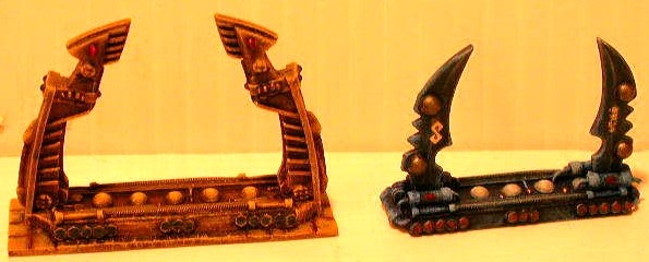

So I take it the consensus is that Exodites can get Wraithgates as it says in this rule set ... ?
Like these I bought or made ...
 Post subject: Re: Exodite Maiden World(4.2)
PostPosted: Fri May 18, 2018 1:19 pm
Yes
PostPosted: Fri May 18, 2018 1:33 pm
Thank U !
