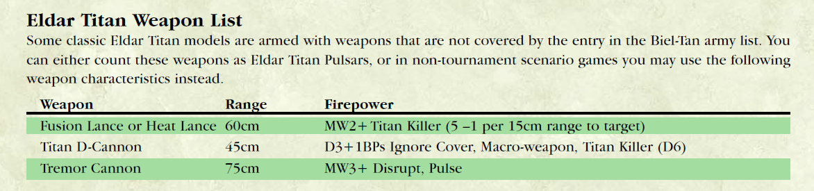

Hey Scarik. I was referring to the stats for phantom weapons published in Swordwind at the back along with some stats for old minis that they weren't selling any more.
They had stats for the D-cannon, tremor cannon and heat lance.
 Post subject: Re: Fir Iolarion Titan Clan 4.2.6
PostPosted: Tue Aug 24, 2021 9:53 am
Posts: 1431
Location: Devon, UK
There are stats for all of those, they just don’t use the exact same stats as were listed in Swordwind.
Yeah I was wondering why the official rules weren't used.
PostPosted: Tue Aug 24, 2021 10:21 am
Posts: 1431
Location: Devon, UK
Because they were just suggestions for non-tournament games.
From memory, they were found to be badly unbalanced when the Fir Iolarian list was being playtested.
The Wargaming Trader
None of that was official. They were simply suggestions for collectors that wanted to use their 2nd edition titans and knight models. They did the same with many of the Leman Russ variants that never got anything official. They were starting points for use but play testing ultimately was the decider on balance. This was especially true for the eldar weapons which are stupid OP

What they said. Playtesting showed that they were unbalanced one way or another as well as being too similar in some cases. As they are currently they are much more balanced and each one has a distinct role.
Ok fair enough. It's a shame because they were distinctly different (except I suppose the tremor cannon).
The heat lance worked more like it did in previous editions. The current playtest one is just the imperial melta cannon, rather than a long range pinpoint lance.
Is there a reason you gave it 0-1? The titan legion list can, if I'm reading it correctly, have a warlord titan with 4 of them. Is there a reason that the eldar can't have more than one melta cannon?
One thing I miss with the tremor cannon (and tried to emulate in my own list) was the fact it was a straight line and hit everything under it. Rather than trying to make it compete with a pulsar, perhaps it's worth looking at it as an army disruption tool?
The way I look at the titan weapons seem like this:
D cannon - short range - most powerful anti titan weapon, as they ignore shields/fields
pulsar - long range - tactical option, good against lots of things but not great
heat lance - medium range - TK weapon, pin point but less powerful the further away you go
Tremor cannon - long range - army disruption weapon, not super deadly, but impacts the enemy army more than other weapons
Perhaps the challenge for me is that the eldar have generally been made distinct due to their rules exceptions rather than just brute imperial force. IE the d -cannon does damage directly to DC rather than playing by the shield rules, or the tremor cannon hits multiple formations rather than just the one you targeted.
so something like:
d cannon - 45cm 3BP, MW, D, Distort*
*Distort - the unit under the central hole of the template automatically loses 1 Damage Capacity (this is applied directly the the DC rather than going through armour, shields etc) in addition to normal attacks
Tremour - 75cm MW3+ D, IC, tremor**
**Tremor - every formation crossed by the shot's line of fire receives a blast marker.
I've also been toying with a monofilament barrage weapon for the phantom as well, which I'm going to print and add to my own. A more anti infantry weapon than the others.
What are your thoughts on adding Skathach wraithknights to the list, or normal eldar infantry as support?
To avoid Phantoms having multiple FF TK attacks is one reason, but I'm not wedded to the idea and I'm planning a 5.0 list revamp as is so if you have notes I am happy to hear them.
Fair points.
You will find the community is largely allergic to adding more special rules. But if there is a way to adapt an existing rule things are fair game. I don't recall anything that ignores shields other than being in Base Contact during an assault, so that would be a hard sell.
For instance I had an idea of letting the Tremor Cannon use the big templates that Spacecraft use instead of the small ones. That would make it easier to hit multiple units.
Currently the Tremor Cannon is a monster against infantry due to Ignore Cover, and the Titan Suncannon is good at range though a lot of the time that weapon still feels a bit weak in general due to being on a 750+ point model.
I'm open to having better knight options, though this is meant to be primarily a titan list so we can't have too many knights. Regular eldar support was dropped several iterations ago for the fact that it took away from the titans. But something does need to happen because as is there's really only two good, 3000pt lists I've found with the current options.
