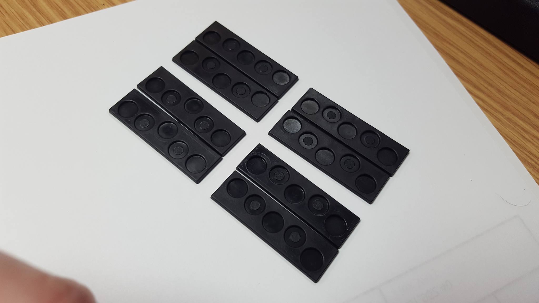

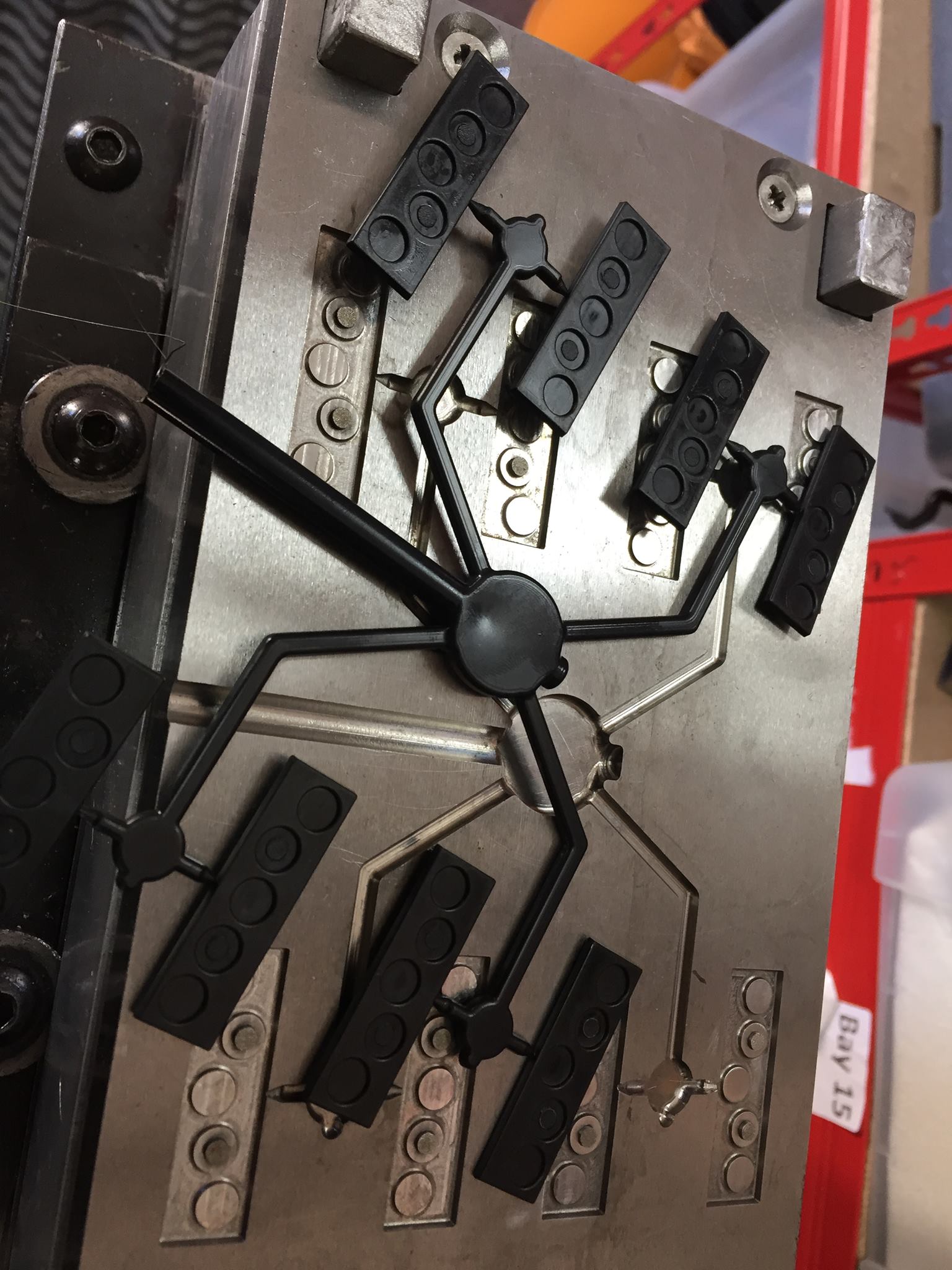

Coming very soon another joint effort by vanguard and troublemaker we have a new bases mould.
These will be 40mm x 12mm

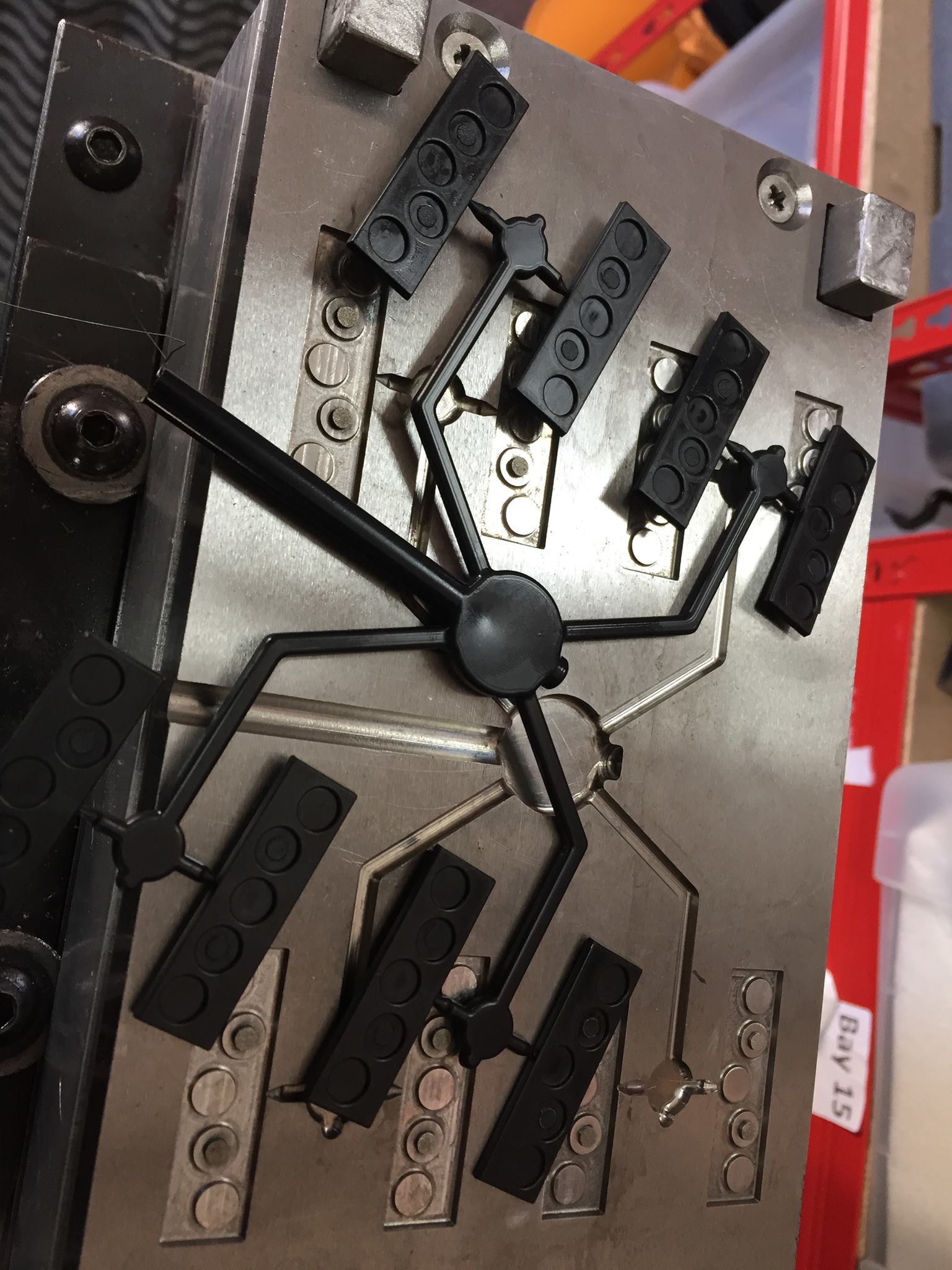

So, from a technical persepective, why did you go with the x shaped sprue? That seems a tad inefficient to a layperson like myself but I'm sure you have good reasons.
 Post subject: Re: Plastic strip bases
PostPosted: Tue Apr 04, 2017 6:30 pm
It gives us flexibility down the line for further tooling that uses some of the same rig, saving tooling costs for subsequent moulds. It's also good for flow distribution.
The circle bases mould also uses an X configuration.
The bases won't actually be supplied from the factory on the sprue. The sprue wastage gets ground up and recycled into more bases (and sprues, that then get ground up...).
