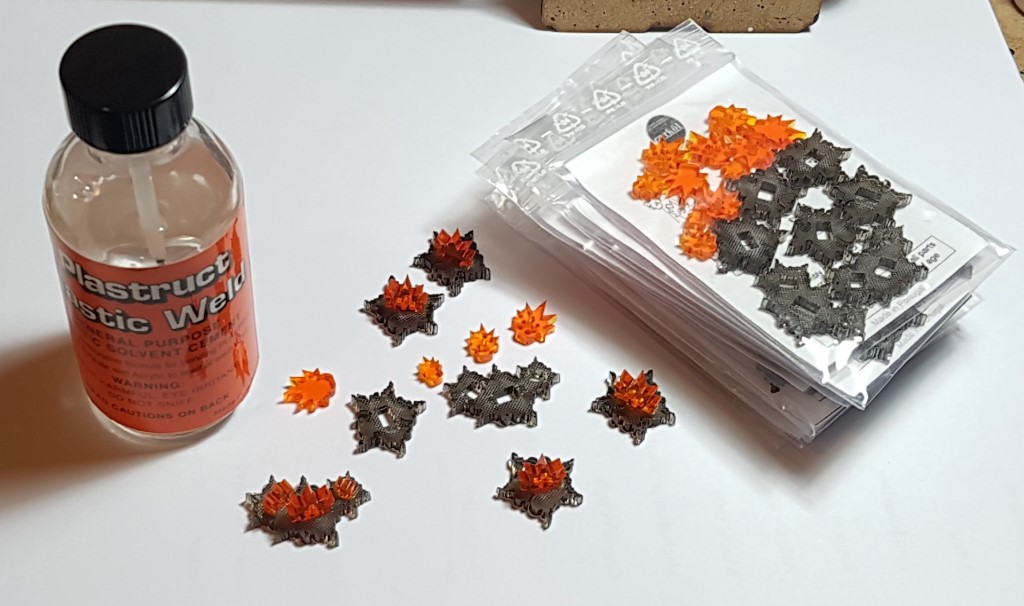

Alright thanks everyone, I eventually found an equivalent in a NZ model shop a couple of blocks from my work. An American brand 'Plastruct Plastic Weld'.
Nasty stuff wtih all sorts of warnings on it, but does the business well and melts the acrylic together!
