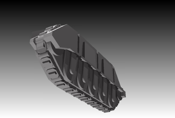

Evil and Chaos - Awesome suggestions, unfortunately, I was well into parting it out before I could add those additional details that I agree would look great. I will apply your suggestions on the next model. I also couldn't figure out a way to add details to the tracks while allowing it to be mass produced in resin casts (not without adding about 4 more tiny pieces).
I don't really understand this.
My attached photo for example is designed to cast in plastic (the least detailed casting method possible) yet the tracks are more detailed.
And added detail to the banding areas is as simple as booleaning any other objects together - being broken up for casting shouldn't affect that.
Fair enough if your aesthetic is more simple in style, but I don't really understand... if it's a matter of being afraid of undercuts, I wouldn't worry, your model would cast happily in metal let alone with the more tolerant undercut limits of resin.

Evil and Chaos - Thanks for that example man! I was really over thinking it. I went ahead and added a small ridge on each track segment. :)
