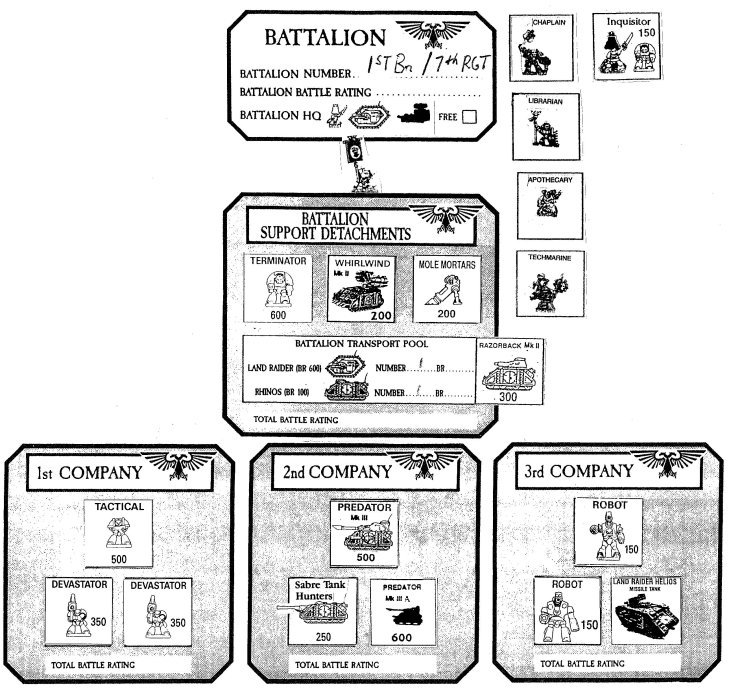

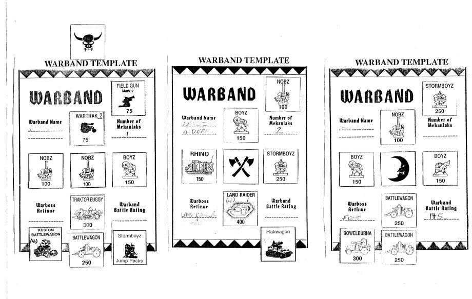

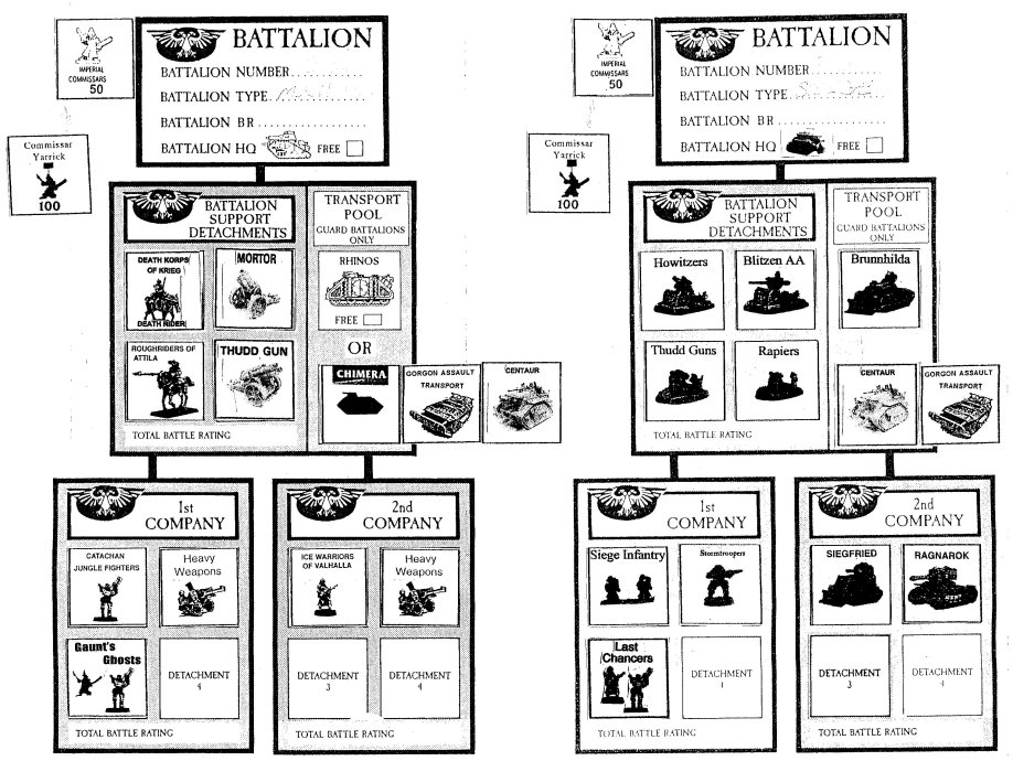

IMO, SM1 was the best way to go ... Here's what we did ... And just a note : Rule #1 Do what works for you ... Rule #2 Don't re-invent the wheel ... everything old is new again ...

 Post subject: Re: Formations: What are they, why have them?
PostPosted: Fri Jul 24, 2015 9:20 pm
I was thinking specifically about you when I answered L4, since I knew you still used them with some modifications. ;)
Why they ever abandoned that method of army construction is beyond me.

I've already decided to use your modifications for the 1st edition update I'm doing, so I figure why not use them for all the systems. ;)
