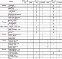

3. Weapon Hard points. There are three options available.
a) Core. The restrictions to titan type and weapon points as described in Net Epic Gold core rules.
b) Anything goes. No restrictions. Go crazy and see whom can design the better cheese.... ;D
c)Traditional. This is the most restrictive, limiting options to what the original AT era titans were allowed.
Use the mighty Mattman Table!
http://www.tacticalwargames.net/taccmd/download/file.php?id=6988&t=1
