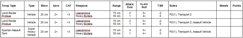

The only one I had drafted for my stats was the Spartan. I have assumed the stats we currently have will be used for the Land Raider Proteus and included a new set for the Phobus to take into account that it is a slower vehicle and has an assault ramp.
This is what they currently look like:
Assault Vehicle is a new special rule I am introducing to cover the fact that marines can charge out the front of a modern Land Raider. Currently it does something like "A stand disembarking from an assault vehicle does not receive the normal -5cm disembarking penalty" or something similar.
Currently I have the Spartan with 4 AD for its quad twin linked lascannons, but as a mentioned above, I could see the To Hit going down to 4+ or the TSM to -3, but since this is meant to be a Super Heavy, this could be one of the reasons that you can get away with multiple AD (and it has hardly any other weapons).

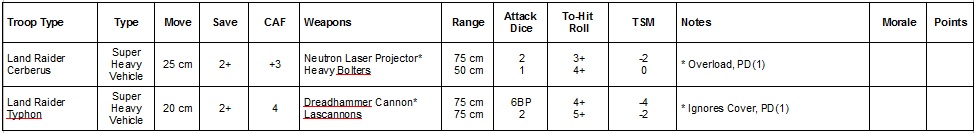

I hadn't looked at the Typhoon and Cerberus previously, but a quick look at what they do and I think something like this wouldn't be to far off.
The Cerberus is armed with a Neutron Laser Projector which supposedly has the same capabilities as a Titan Turbo Laser, so I just used the same stats, but it suffers from feedback problems, so I gave it another rule I am bringing in called Overload (I was planning on using it or something similar on the Land Raider Terminus Ultra). Basically whenever it fires and you roll a 1 to hit, it causes a hit on itself with TSM.
The Typhon carries a Dreadhammer Cannon which is supposed to be an uprated version of the Thunderer on the Vindicator. So I upped the range a little, gave it the same To Hit, but made it a barrage weapon and increased the TSM slightly.
I also upped the CAF compared to the other Land Raiders as it is meant to be a hulking beast and can cause more damage when it rams.
But then with the Spartan and Cerberus being Super Heavies to, I could easily see their CAF going to +4 and the Cerberus going to +5.
Hope that helps.

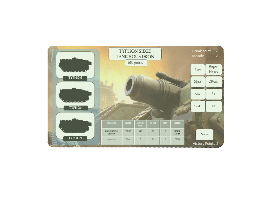

Son asked if it could be done on cards like Pokémon
Not at all serious just some fun.
can be put on a poker card though :)
Points just made up sorry Magnus you education of this poor soul slipped in a second of madness.
Squiggle

SquiggleAmp wrote:
This is what I pulled off the forums don't know if its up to date only took it off two days ago
Cheers Squiggle, I knew there was something somewhere.
Not just fun, but a bit de ja vu ;) Those look sweet. Though just be careful when using images from GW, they sometimes don't like it ::) .

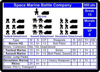

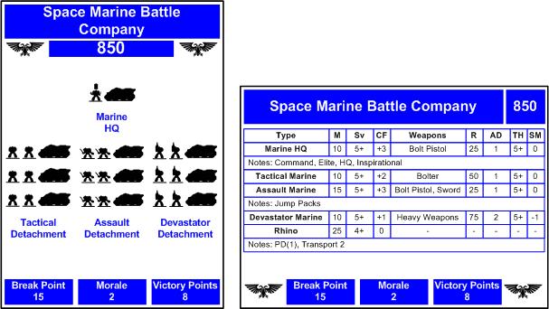

Several years ago I thought about remaking the army cards that we used to have in 2nd Ed Epic and making their size that of a CCG card (Pokemon, Magic etc), although I didn't get very far, this is one of the ones I cobbled together:
I didn't have access to any fancy software and I am not exactly artistic, but they turned out alright.
Let us know how you get on with putting some of the rest of the formations onto cards, especially the variable sized ones as a lot of people were very interested in having something like this available in their games of Epic again, so whatever you learn while doing it for your Heresy project, I am sure we can make use of it for NEP.

Cool Mattman, like the second one and it is probably the direction I would go for a company card. The information is a squeeze with a detachment, I think 2 sided is the best for a company card due to the amount of info it has to hold.
No cease and desist yet from GW, fingers crossed :)
