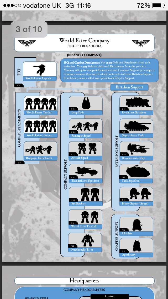

I like them flames of war system it has a lot going for it. We could be creating very thematic armies with equipment and support that would be following along with specific type formations. Armoured companies could include infantry but would have it in limited numbers, we could have lists specific to clans or imperial worlds, chapters and craftworlds. See example below for a heresy era space marine list. I think it has great potential not only because it looks cool but the forces would reflect what the companies, clans, chapters would have available.

Plagiarised and adjusted quote from Dakka Dakka. It would ensure player careful to research the units available to the army and style you want to play. The wide variety of force structures available to each army mean that, unlike Epic, not every unit is available to be used by your chosen force, even if it is available at the same time.
Death Corps of Kreig would not have as many Leman Russ's available and would maybe have Malcadors as the MBT instead, Snakebites would have access to Junker trukks and Boarboyz instead of Trukks and bikes, I Like this idea and will definately throw some ideas on paper. it is similar to the card system but I feel it will make people think more about who to play and what style suits them best. I also like the SM1 system but it lacks a certain grounding in force selection in terms of what a certain commander would have availabe it is more of an all you can eat buffet :)

SquiggleAmp has the correct view of this and that is how I wish to fashion the army construction templates.
The only thing I will add that such template can also modify how many and how large are the formation activation and attempt to resolve the "activation issue".
