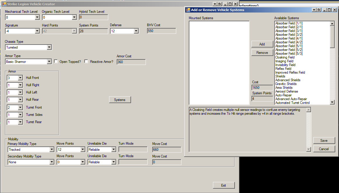

Though it aint much to look at now, attached a screen shot of the interface at the moment (It may look 100% different when released, but this proves I've done something!)

Awesome! I think your Hull armor values should only list "Sides" like the Turret do, so you end up having only 6 entries:
Hull Front
Hull Sides
Hull Rear
Turret Front
Turret Sides
Turret Rear

I'll fix it so only sides are shown at some point, instead of Right/Left... I can't think of any historic unit that would have different side armor (Perhaps the Grant due to the side mounted 75?, doubt it tho).
