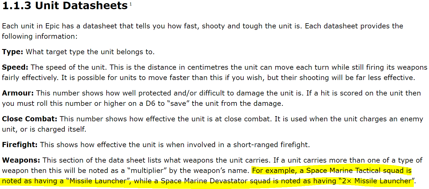

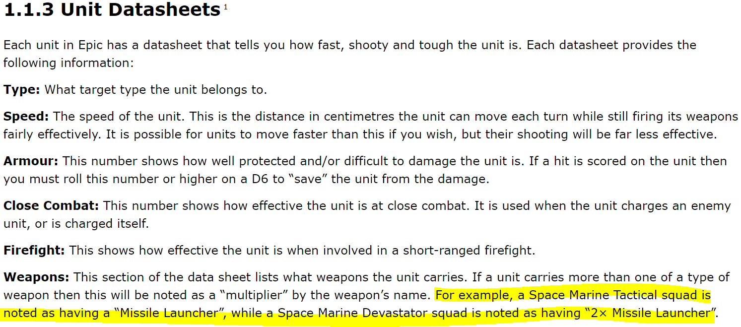

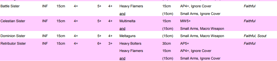

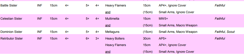

Could I ask for a clarification in the unit stats? A lot of the infantry units seem to have multiple heavy and special weapons per stand indicated. For example, Battle Sisters have "Heavy Flamers," Dominions have "Meltaguns" and Retributors have "Heavy Flamers" and "Heavy Bolters." Compare this to Celestians, which are listed as just "Multimelta."
Section 1.1.3 of the NetEA rules is pretty specific that if a unit has multiple heavy/special weapons, the data sheet will say "2 x [weapon]."
So do Battle Sisters have 2 Heavy Flamers, Dominions have 2 Meltaguns, and Retributors have 2 Heavy Flamers and 2 Heavy Bolters per stand? Or are these all typos and they only have 1 of each per stand?
If it is not a typo, it's worth noting that the 2.1 SoB unit stats seem to be inconsistent in how they're indicating unit armaments. Penitent Engines, for example, are indicated as having "2 x Heavy Flamers."

Not quite following. None of those lines have a 2x out in front, so they all have a single weapon of those listed. Is the "and" confusing you? E.g. the battlesisters have a heavy flamer that grants an ap4 shot as well an IC on their FF attack.
Or is it just because the names are plural? If it's that, ignore the plural. As you say you only get 2x if there's a 2x at the start of the name.

Sorry if I was a bit unclear, but you answered my question. I was confused because the weapons are listed as plural on the datasheet. Thanks!
