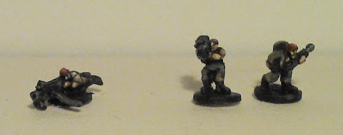

Some Sci-Fi Jungle Fighters
These are based on the classical plastic Guardsmen with a couple of headswaps, new posing, green stuff work and various other bits. Sadly there were some molding issues with three guys. Now two have a slightly crippled leg, but its nothing a little GS can't fix. The other issue is the flag bearer, it seems I was a bit sloppy with the end of the flag. But since I only need a few of those, even this is no real issue.
I want to expand these to another unit of 10 guys, complete with sniper rifles, plasma gun, bush hats and Ghillie suits. The plan is to completly cover the miniatures needed for the Mirali Skyraiders and Catachan Deathworld lists.
