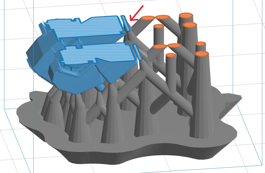

This process will repeat itself until all of the pieces are connected. Sudden "erruptions" of pieces will also tend to be soft or mushy. For example, this tab part that suddenly appeared at the shown layer.

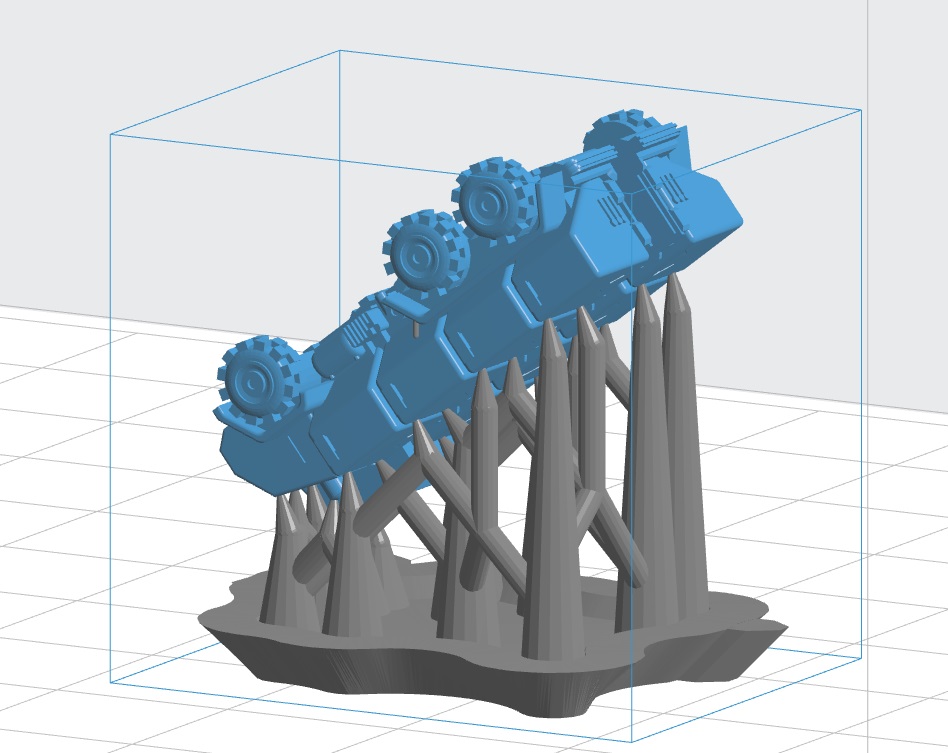

So, one has to use support structures. FormLabs offers software to automatically orient and place them, but it's unfortunately clunky. I can't blame them, it's a difficult problem.
The software usually over-embeds to model and yet still doesn't address some of the weird topology issues.

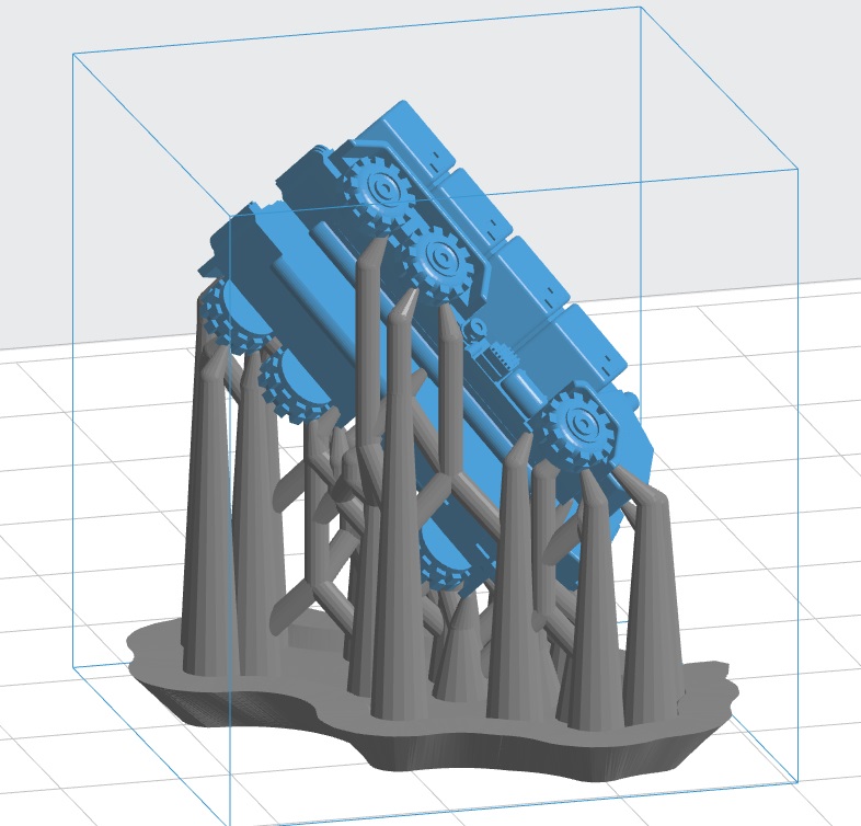

So, through trial and error I've learned how to position things a little better. Here's my third take on personally applying the support structures:

One then examines the layers for "blue islands" which would represent lost detail. This looks OK, because that little bit of blue is connected to the support structures, represented as orange.
Don't confuse support structures with a deposition printer's support material. The SLA support structures are the same material as the model.

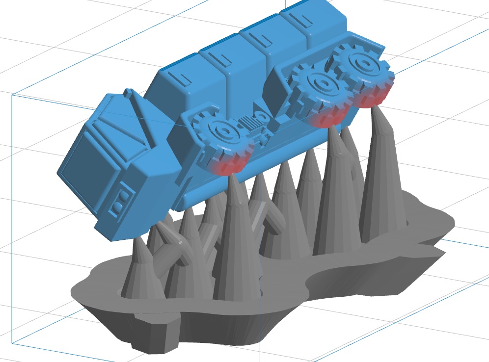

Here's a more-better-er-est orientation on a single part.
Note that the tires/tyres are still showing as red, even though I checked the layers and only a small bit of the inside tread would be lost. Their automatic heat maps sometimes get things wrong.
