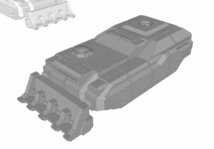

Just found this little tidbit, might be an idea for turret variants...
I've been removing the rivets, the model feels a bit empty at the moment. Will probably have to add other sorts of details to the hull...

sorry but I love rivets. good points about making sure they're not too close to the edge but removing them entirely just kills the model for me but hey, what do I know? :(
 Post subject: Re: Modeling bits for 3d printing
PostPosted: Thu Mar 31, 2016 3:19 pm
I know what you mean, the character of the model is kinda gone. I need to ponder a bit about them on how to either (a) bring them back or (b) come up with an alternative detailing that'll look as cool if not cooler. :)

Hah! yes, I agree with Jimmy, rivets (I would think of them as large bolts that let you quickly swap out damaged armor plates) are good to have as they provide more detail for the model without a lot of effort. My point was to make you aware of issue that can crop up with them so you could adjust, not remove them entirely!
EDIT: I'm not sure how large these guys are, but I'd aim to keep the rivets about .75mm to 1mm away from the edge of a plate.

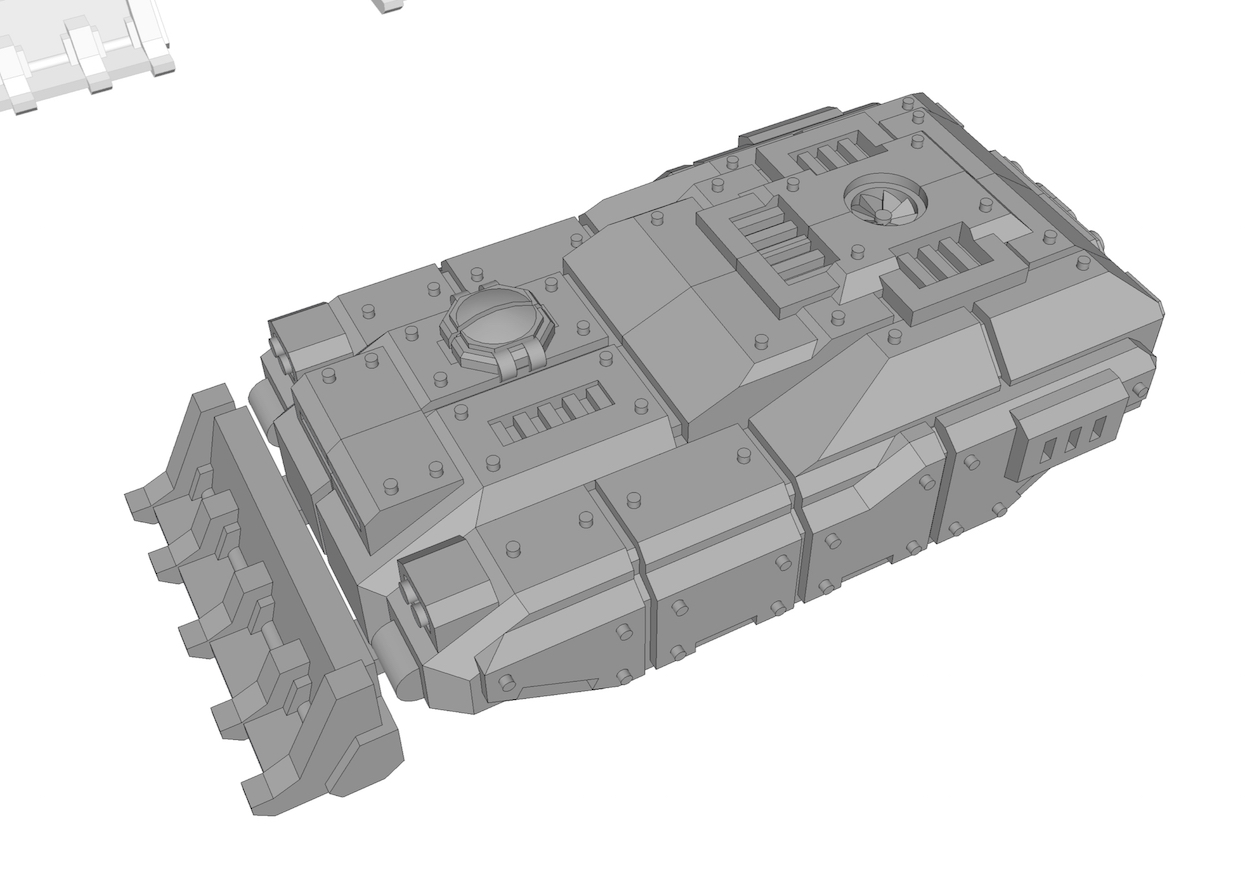

The tanks are about 36mm x 21mm.
I've brought back the indented rivets, or perhaps I should have them stick out of the surfaces instead?

I think sticking out would be easier on the molds. Indented would be a tiny little bit of silicone that would get pulled off easily

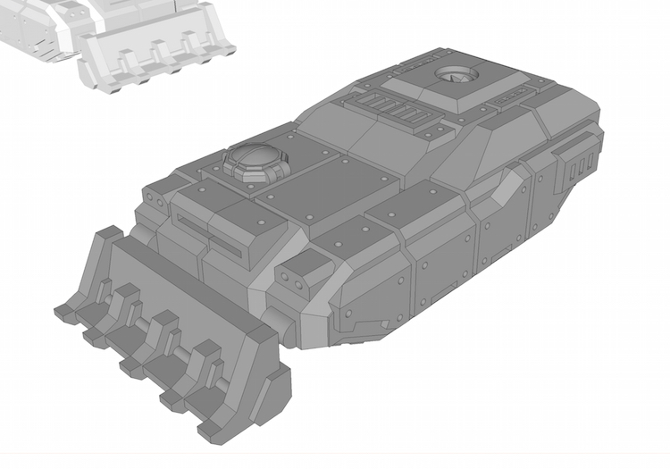

Added normal rivets to it again, and also added some additional details.
I'd imagine that if you don't like the rivets, they can easily be removed.

It's looking good dude but what happened to the hull HMG turret?
PostPosted: Sat Apr 02, 2016 12:27 pm
Oh the turrets are still there, just wanted to show you the hull without the turret on top.
I'm still toying with how to design the HMG turret as a separate bit. That way allowing players to also have a totally unarmed version if they'd wanted one. :)
