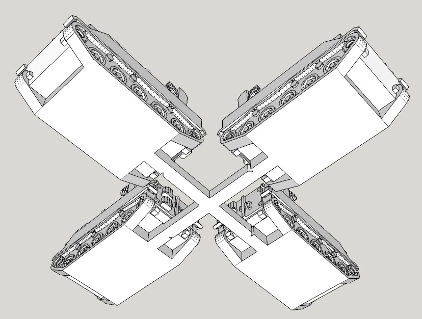

I've attempted to order a test print of APCs three times now. I've been arguing with the SW tech-drones that they can print these since the sprues sit flat on the print bed. I'll probably have to appeal it higher, but what I'm being told so far is that the techs choose the orientation, not me. That really pisses me off, because it means that all the work I might do on a product's printability can be wasted by some tech's arbitrary reorientation of my model.

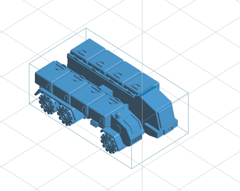

Alrighty, let's take my Charybdis battery truck as an example. In this case I got lazy and saved two parts to a single file. This will complicate matters, but serves to exaggerate a point:
With deposition printers, lots of pieces in a single model is OK, because the support material software can handle that sort of thing automatically.
With SLA printers, a single piece per model is better. If your model has lots of pieces, separate them so they can be oriented better to suit the printer.

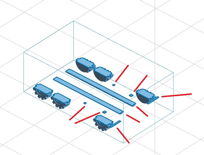

With a deposition printer, the build head moves back and forth per each layer, depositing build and support material. The build plate usually moves up and down, but I've seen some printers with heads that move.
With an SLA printer, the build plate moves up and down into a tank of liquid photosensitive resin. The plate traps a thin layer of resin between it and an optical window, through which a laser shines and hardens the resin.
With deposition printers, "undercuts" aren't a concern due to the support material.
However, each can be envisioned as building the model layer-wise, like so:

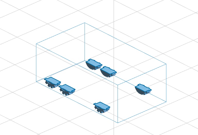

In the case of an SLA printer, EVERY part has to be connected to the base plate, or it won't stick to the model. For example, there are no connections between the base plate and these little islands of blue.
Those guys will float away and leave the underside looking mooshy.
